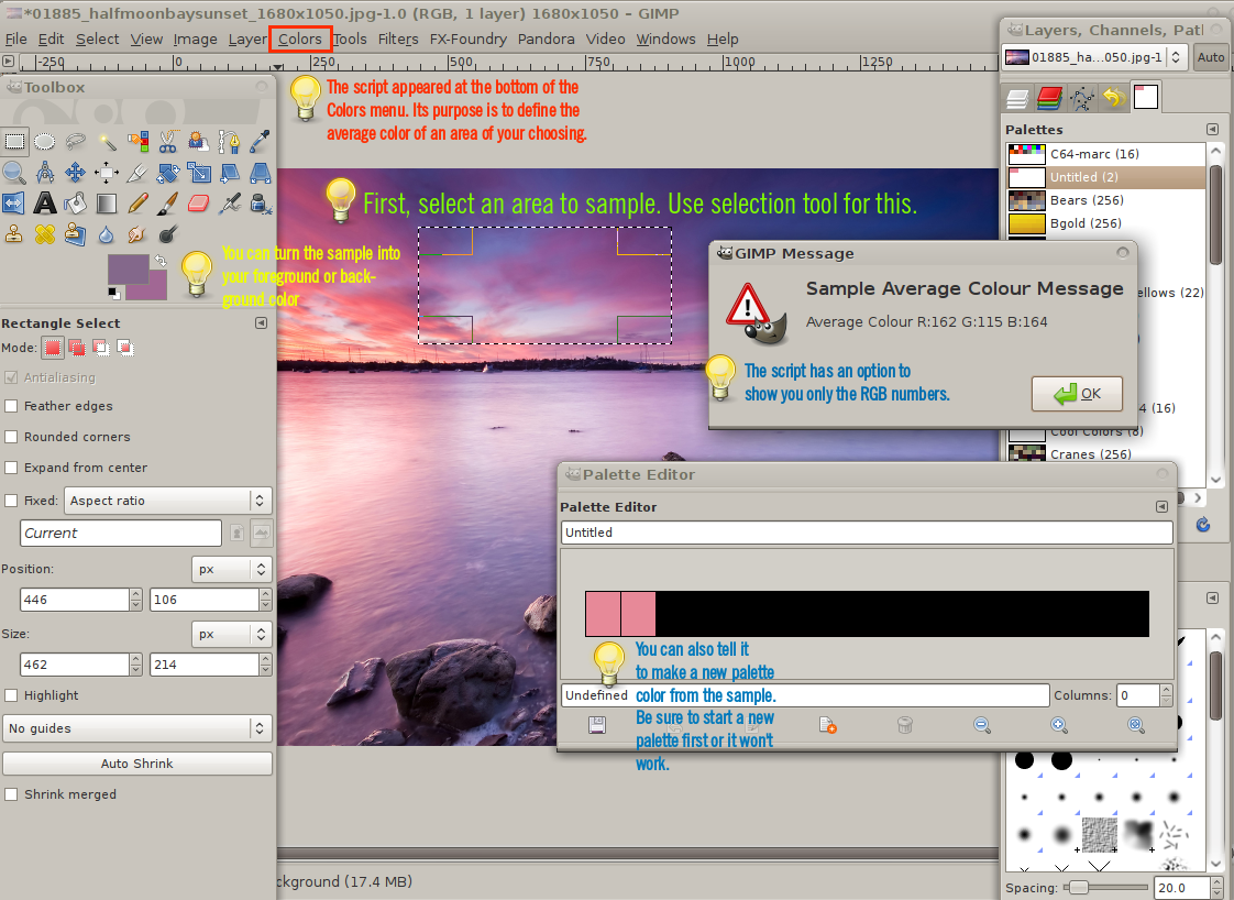

While discussing average colour sampling, I wrote this script a way back: http://registry.gimp.org/node/16678 or download from my site here: http://www.silent9.com/incoming/scripts ... colour.scm
It simply samples the entire image or active selection colour, and allows you to either:
- Display the RGB or grey values
- Set the foregound colour
- Set the background colour
- Add it to the current palette (if editable)
There is a toggle to sample just the layer, or the merged image.
It registers in the Colour menu as "Sample Average Colour..." and should work for RGB, indexed, or greyscale images.
Here is a quick pictorial explanation:
-Rob A>
