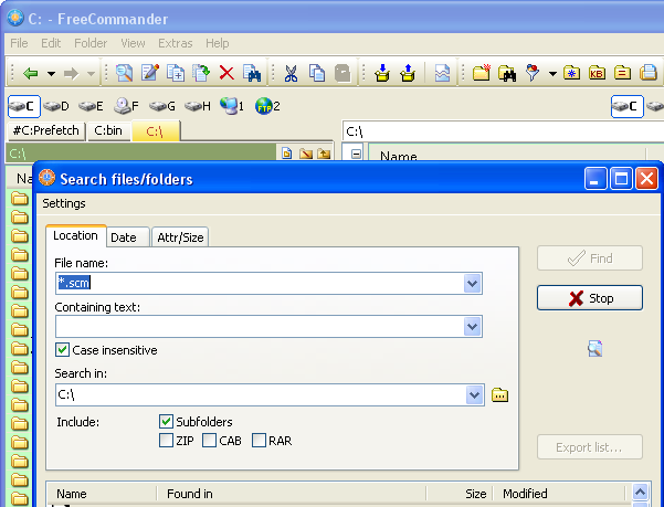

Can use to search for FC ?
http://www.freecommander.com/fc_downl_en.htm
