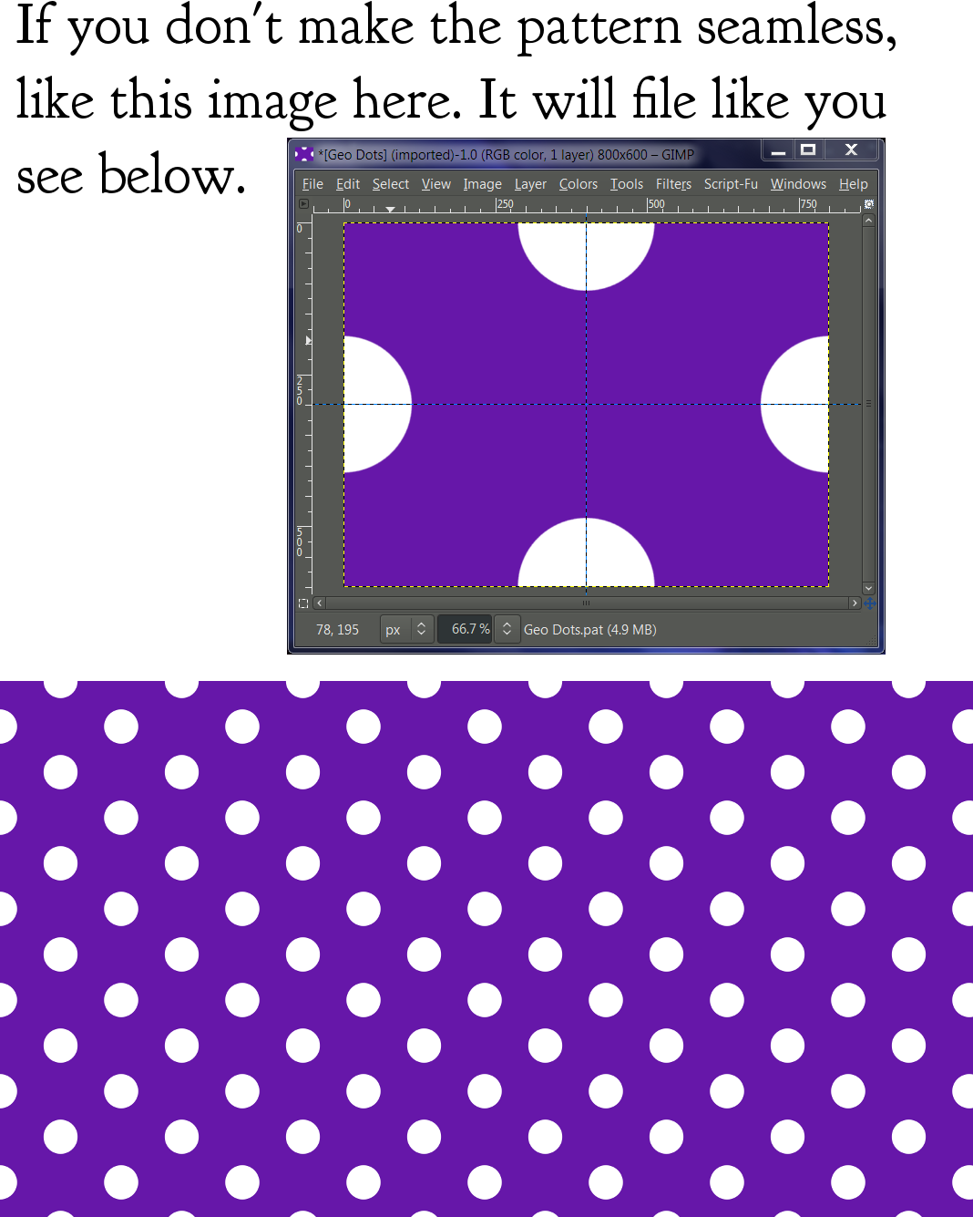

Check this out Molly...

Thanks Wallace, as long as I can get those edge ones centered.

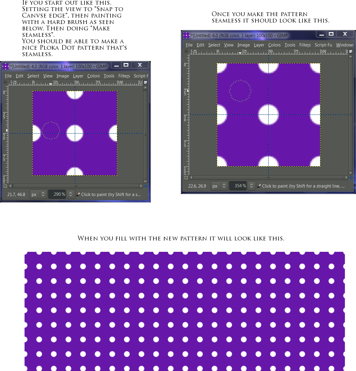

Symmetry is not rocket science. Mollys pattern has an offset so takes a little more thought.
Always best to start off with a pattern in mind rather than make something than try and adapt it.
It can be done in a minute. http://www.youtube.com/watch?v=Ph429_vY7K4&hd=1

So you are saying you painted the white dots on the purple layer?
Yes you can do it that way or make it transparent.
You can also do it like this... (White dots on Purple)

Thank you Rich, You have a very nice voice for giving tutes. No it wasn't hard.
