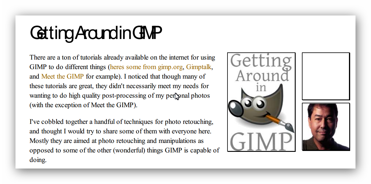

Hi Pat.
First trial using Iron.
Got an almost completely readable text, except for the title.
See attachment

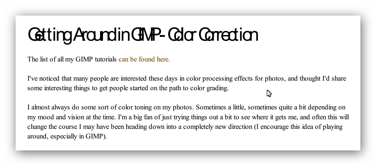

PostPosted: Mon Jun 09, 2014 11:50 am  (#10)
second trial, using Opera
same result (OK 99%, not the title - even if somehow readable)

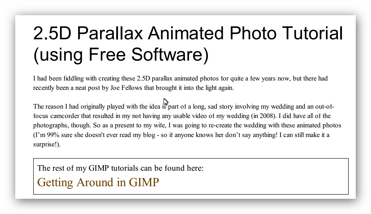

PostPosted: Mon Jun 09, 2014 11:54 am  (#11)
thitd trial, using Avant
same as previous two
(I will not try Firefox, because the only one that was successful also before your modifications)

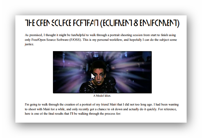

 Post subject: Re: getting a READABLE PDF out of Patdavid's tuts (SOLVED)
PostPosted: Mon Jun 09, 2014 12:25 pm  (#14)
OK Pat.
Just one single trial, because all three browsers behawe in a similar way
ALL OK !!!
May I now say: thanks! thanks! thanks!
