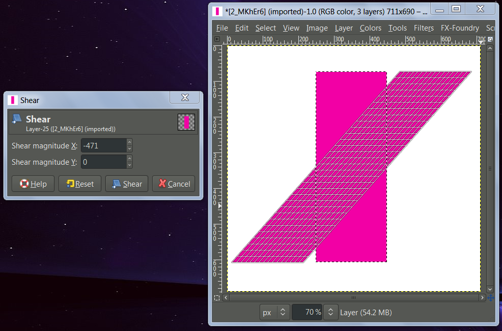

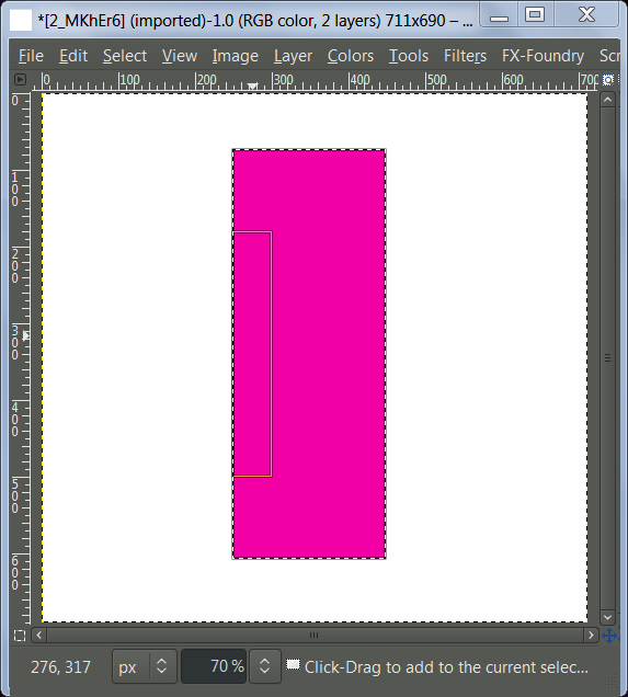

There are many ways that you can do this.
Here you can use the Rectangle Select tool, :rectsel and create a selection as seen below.
Fill this selection with your color.

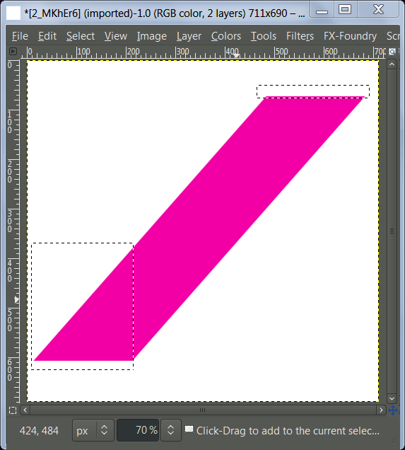

Use the Shear Tool, :shear and move it to the angle you want.
Use the Rectangle Select tool again :rectsel to chop off the ends.

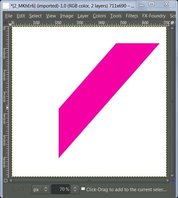

You should end up with something like this.

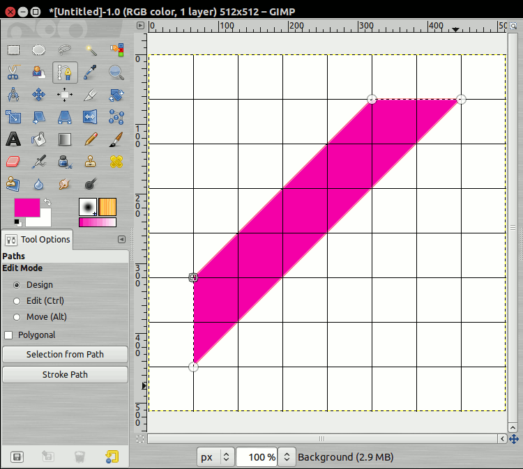

If you go with ofnuts suggestion using the path tool, use a grid.
1. View menu | Show Grid & Snap to Grid
2. Image menu | Configure Grid...
For example, my image 512x512, grid size 64x64, no offset

thank you Wallace and how to set shear to degree like 45 degree
 Post subject: Re: How to create image like this ?
PostPosted: Fri Aug 08, 2014 7:55 am  (#7)
Posts: 14287
I hope this helps.
Also look here for more information... http://docs.gimp.org/en/gimp-tool-shear.html
