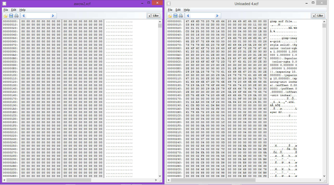

The file is two million bytes of nothing but zeroes.

Left side is your .XCF and the right side is one of mine. As you can see all the coding in the file has been wiped clean. Sorry I was unable to help.
