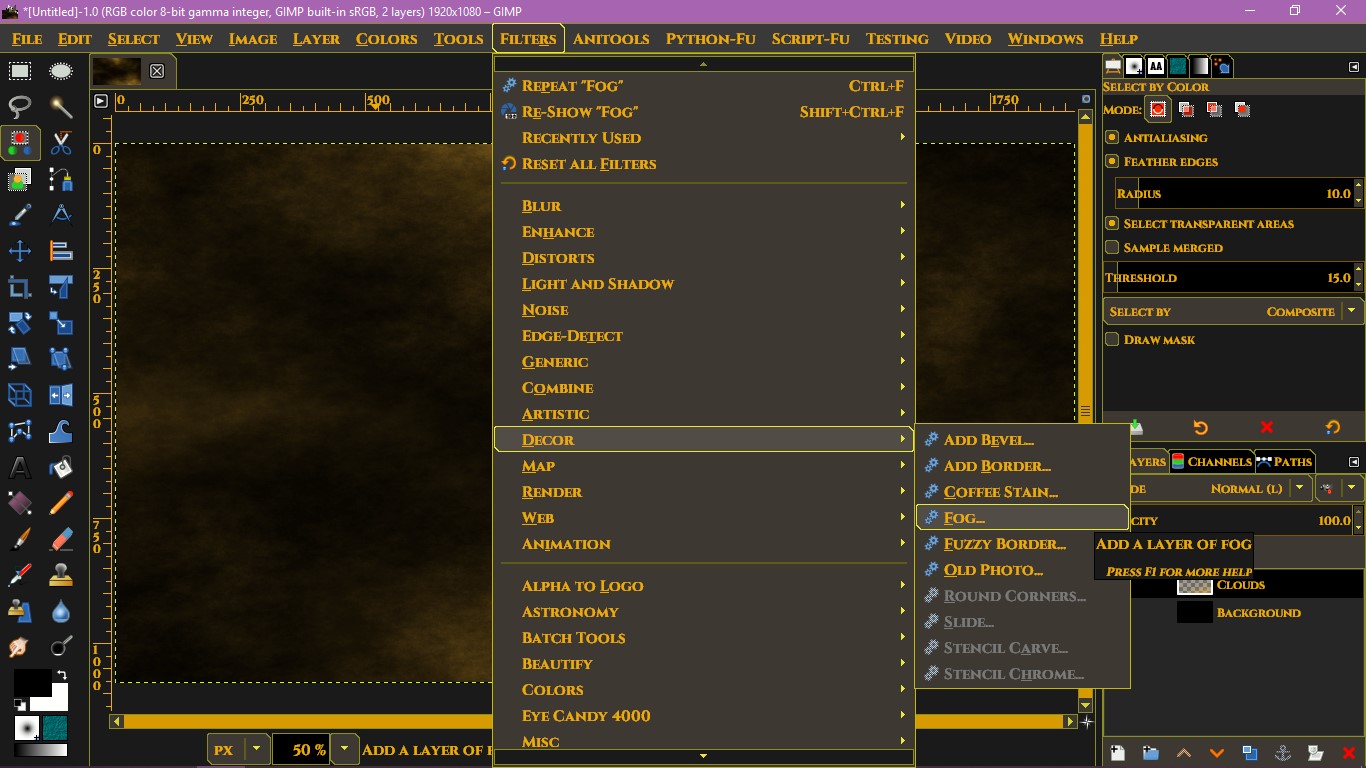

Hi Iridescent. Try this location: Filters> Decor> Fog. That is where I I have mine in Gimp 2.10.6.

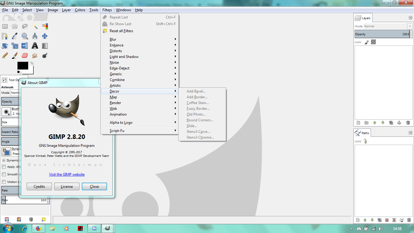

@Pocholo, I don't have the option there:
Also @ofnuts, I don't have those options either. What can I do to fix this?

There should be a "python" subdirectry in the Gimp install tree ("C:\Program files\GIMP2\Python", I think), with a python.exe in it and many other things). If you cannot find it, then reinstall Gimp and make sure that the python support is installed if it is an option.

Sorry, I didn't read that you Version is 2.8.20. Ok if don't have it in: Filters> Render, just download the i just post it and place it on your personal directory C:\Users\YourName\.gimp-2.8\plug-ins . Start gimp and you will have it in the location: Filters> Render> Fog. I hope this help you.

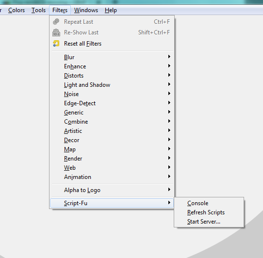

I think ofnuts is right about my issue. I don't have XHTML or Open Raster exporting options, and here's what I have instead in filters
Is there any way to fix Python?
See reply from Ofnuts on previous page (post #5)

Sorry for taking so long to reply. I reinstalled as was suggested and it fixed everything :D

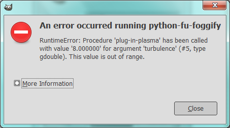

As for the the turbulence issue, the highest I can put it is 7. 8+ causes it to fail. It says the value is out of range. Here's a screenshot of the error message if anyone can help me resolve this:

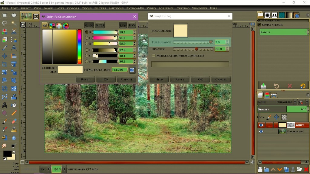

I have the same filter on a .scm file created by a Coder: “kward1979ukin” deviantart.com, then was last modified/tested by Paul Sherman [gimphelp.org] for Gimp 2.10. But he still didn’t change the command line (changes on red);
“SF-ADJUSTMENT "Turbulance" '(1.0 0 10 0.1 1 1 0) to '(1.0 0 7 0.1 1 1 0) when you go higher than 7, it will crash also.
I modified this line from 10 to 7, the level go as high as 7 and it work great!, By the way, the color picker on this script works with the newer version Gimp 2.10, no crash at all.
Place the fog.scm on the same place you have the 3rd party scripts in you personal Gimp directory: C:\Users\YourName\AppData\Roaming\GIMP\2.10\scripts and start Gimp and you can find it in the same location you had it in Gimp 2.8: Filters> Renders> Clouds> Fog. I hope this settle for you.
