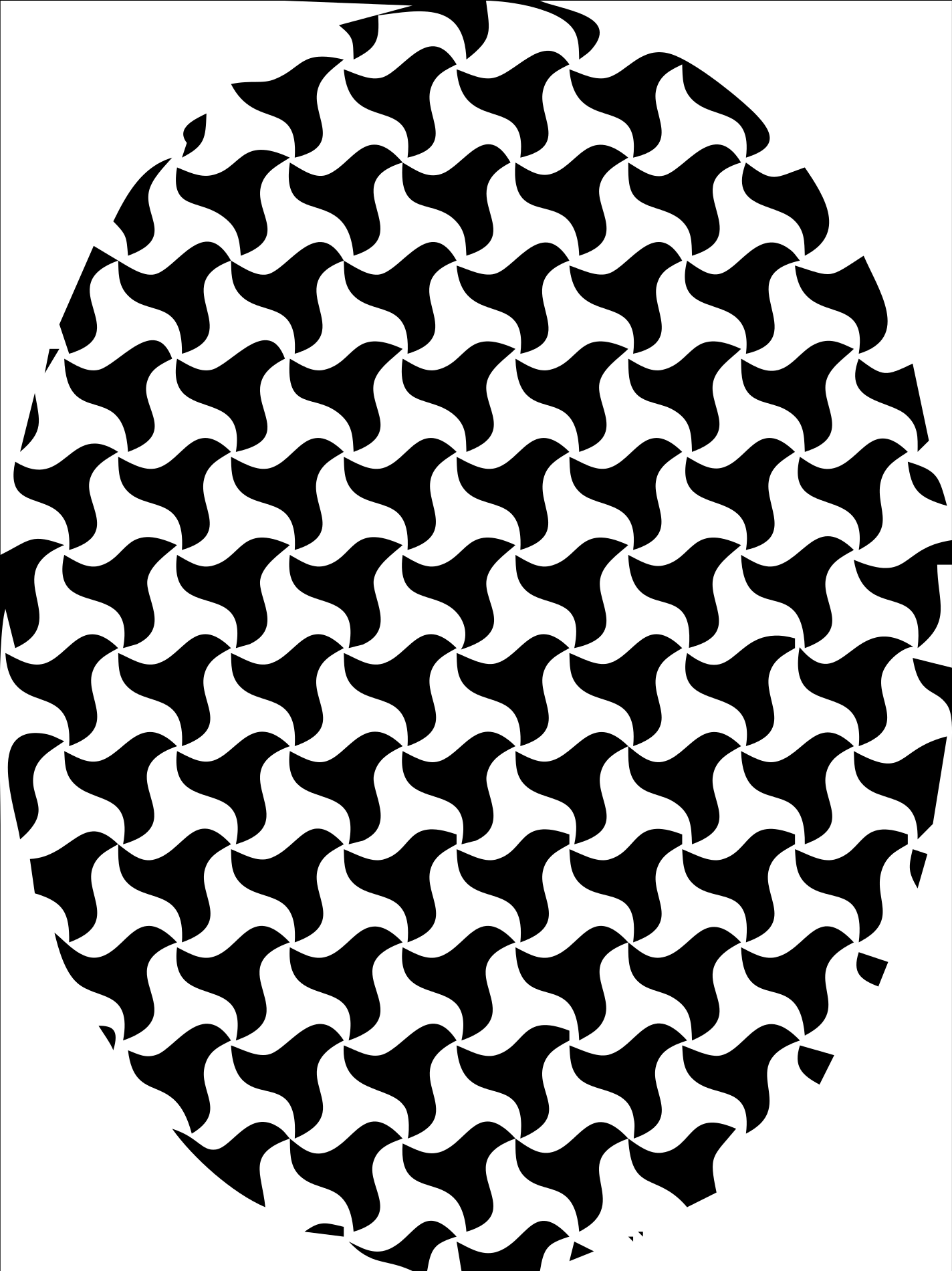

Completely new user here. I'm trying to use some geometric patterns to create a tattoo stencil. My issue is that the image must be enlarged and that shows the pixelated quality of the edges of the shapes. How do I create a smooth curved border of the shapes from this? I've included the files. These will be blown up so that the shapes will be about 3/4-1" diameter once printed.

Yes that is it! I'll have to chew on your instructions and try to tackle the other one. It is the tougher of the two and the one that has me worried. If you find out where you got the Lanczos3 filter let me know.

Your other one didn't appear to need retouching after I blew it up (same procedure), so here it is. Hope it helps.
Also according to gimp.org, Lanczos3 is built in by default.

I made SVG file from the images you uploaded and was able to create these patterns using them.
Their able to be scaled to whatever size that's required.
There are a few anomalies, but for the most part... their pretty clean looking.

jazzon wrote:
Well done Wallace. I never thought of using svg. I guess I should have, it is all hard edges. Live and learn!
Scaling raster images from small to large, almost always renders unfavorable results.
Which can be difficult at best to try and correct.
The svg's I uploaded aren't perfect,
but they are scaleable and cleaner then any enlarged raster image would be.
Given the nature of the patterns involved.
