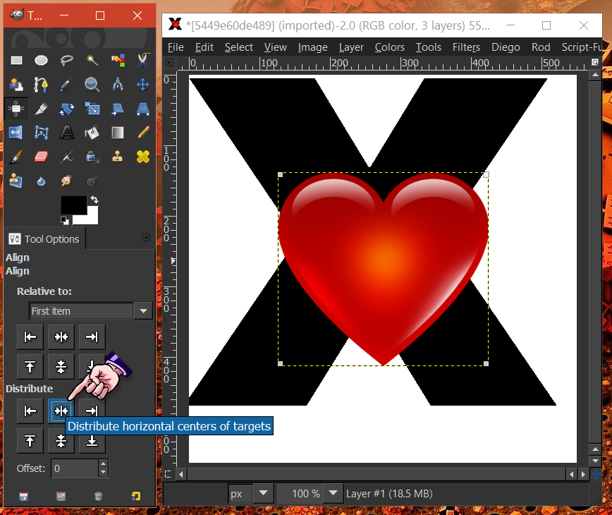

With the heart layer on top of the "X" layer.
Go to>Autocrop Layer and click it.
Next select the Alignment Tool and click on the heart.
You will see a dash outline around the heart,
with a small white box in each corner.
Indicating that the alignment tool is active on the heart layer.
Click on Align Middle of Target.
Next click on Distribute Horizontal Center of Target.
Do the same for the "X" layer and it should look like this image below.

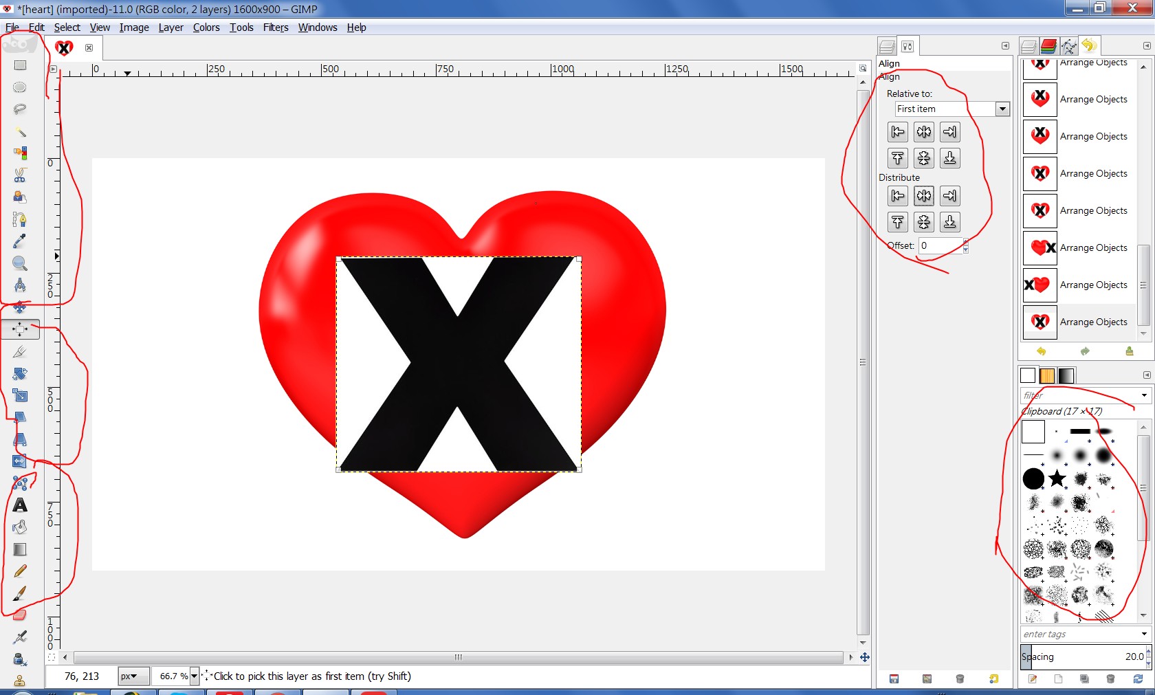

transparent?? in this case my cross X is not transparent right? How to make it transparent?
another thing is , how to make the buttons and icons and things bigger (circled by red). My eyesight is not very good

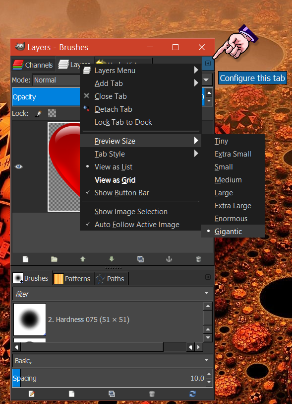

Another thing is, how can I let the layer windows appear like the one on your screen,
aligning next to the main editor windows, instead of flowing on top of the main windows??
Layers are used to combine different images, one on top of another, in Layers
Open As Layers, allows you to open a single image or multiple images as layers in a single canvas.
I believe your Gimp interface is set to Single Window mode.
You would need to change this by going to Windows>Single-Window Mode.
kenny1999 wrote:
this is the screen I have, can I have bigger text, bigger image display like yours??
and the heart does not appear on top of the letter X, it starts another windows
You need to configure the tab to show the preview size you want.
You could select the white parts of the "X" image using the Fuzzy Select Tool and delete them.
You can also do a Color to Alpha, by going to Layer>Transparency>Color to Alpha and select White.
To make the tool icon bigger. You would need to install a Gimp Theme, that has Large tool Icons as part of it's theme.
