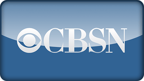

Hi folks! Am new to the forum and to gimp, tho' I have done a bit of work in photoshop. I've been trying to do something that seems like it ought to be easy... make a TV channel logo icon like this one:
I've made ones with more of a 3d effect in photoshop like this one I just made:
But I need to replicate the 1st one above. It looks much simpler, as it seems to just have a gradient laid over a selection as I did with photoshop above. But I can't make any selection with the wide curve at the bottom, and the rounded corners at the top corners. I'd like the sharply defined edges around the gradient. Mine are too soft. Would anyone here know how I might achieve this in gimp?

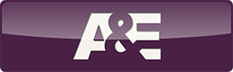

Stumbled over this when I tried adding lettering by pasting fuzzy selected text from my previous logo into what I'd made from scratch up to the point of applying a gradient.
Will see if I can figure out how to overlay a transparent gradient.
 Post subject: Re: Need help laying gradient over selection
PostPosted: Thu May 19, 2016 8:37 pm  (#8)
your gradient layer needs to be between the background and the text layers.

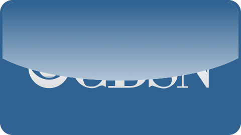

What a terrific forum and group of people here. Putting the gradient layer underneath the text pasted from a selection from the original got me to this:
I did have to fiddle with the layer scaling and where to start and stop mouse motion for the gradient for quite a while until I was satisfied. And I wish I could figure out a universal method of setting guides to a coordinate where I could start the ellipse selection to minimize how many tries it takes to get the results I'm looking for. But I guess that's just a matter of doing this enough times, and establishing a feel for the process.
This pretty matches the example I was trying to replicate. Now I'll have to sit back and contemplate whether or not to try giving the button a more 3D effect like i'd been doing with Inner Glow in Photoshop.
Thanks 2-ton & Dalia :)

Hey Dalia. It looks really great as I posted it above. But when I scaled it down and placed it inside an app skin I've been working on, it lost the crispness of the borders of the image. And though the 3D effect that blended the white and blue on the outer edge of the gradient layer looked good originally, when the image is scaled down it looks more fuzzy than crisp too. Here's a comparison.
What do you think??

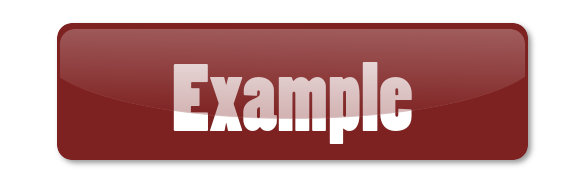

I wish I could help you out here. I know there are pros on this board that might have an answer for you... Having said that - this amateur can only come up with (1) Because the background is dark, perhaps a slight shadow with the opacity at 100 will enhance the bevel effect and (2) What if you worked the original to the scale you ultimately want it to be?
I took the liberty of copying your example and duplicated it to work on the beveled one only - I went to Filters > Enhance > Sharpen. Then Filters > Light and Shadow > Drop Shadow and gave it the following values > Offset X and Y "-1" Blur 15 Opacity 100.
Here they are - your original and the one I played with:
Image Image

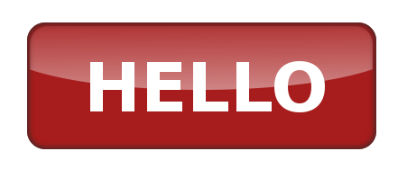

I can't believe it. I finally followed a tutorial and it worked! Thank you, Dalia...well written!

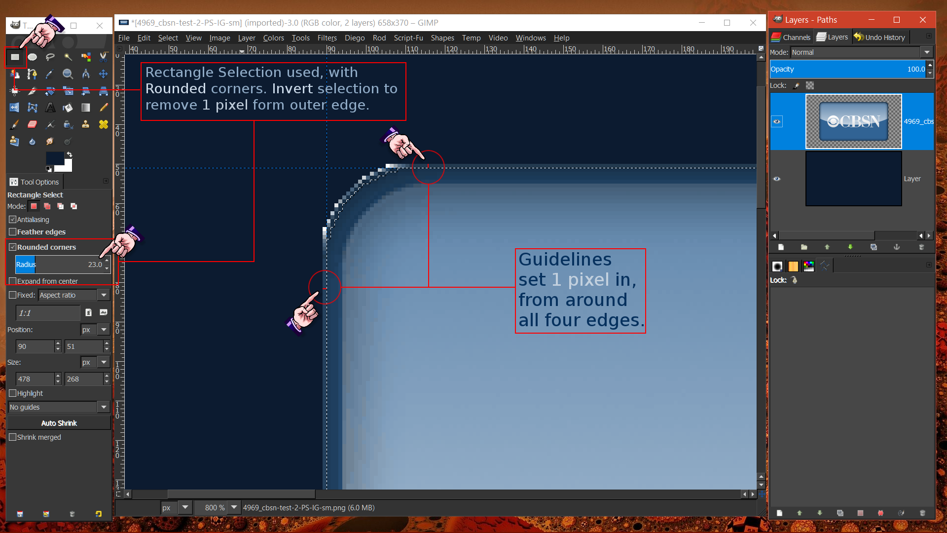

You will always loose image quality whenever you scale raster images.
The amount of scaling is also a factor,
when it comes to image quality loss.
Knowing the exact size required and saving the image as a PNG.
Should help to keep the quality of the image intact/undamaged.
Below is a suggested process,
which I sometimes employ.
To help images such as yours look crisp and or clean.
Note:This process doesn't include scaling of the image.

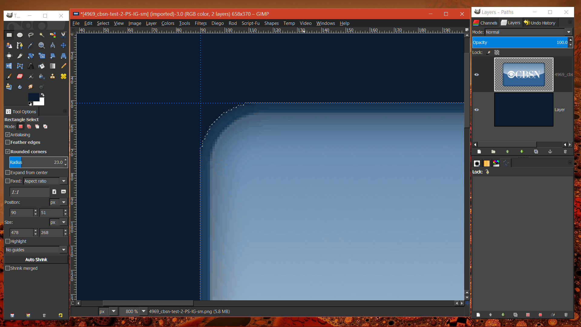

Your specific image has white anomalies around it's outer edge.
This could be removed.
View of image,
with anomalies removed.

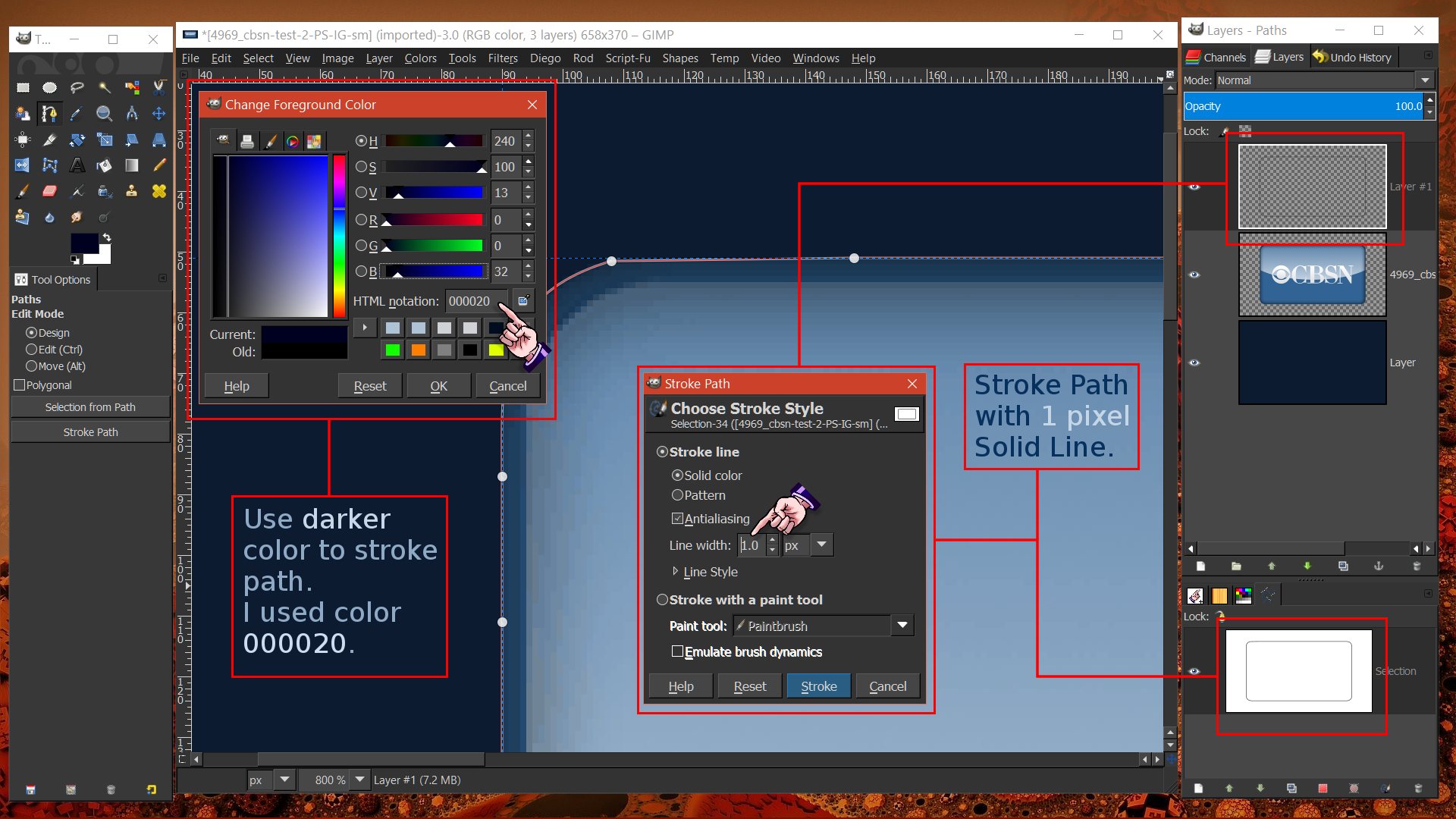

Creating a Darker outer edge,
can help to make the image look much nicer.
Once the outer edge has it's anomalies removed.
You can then create a darker outer edge.

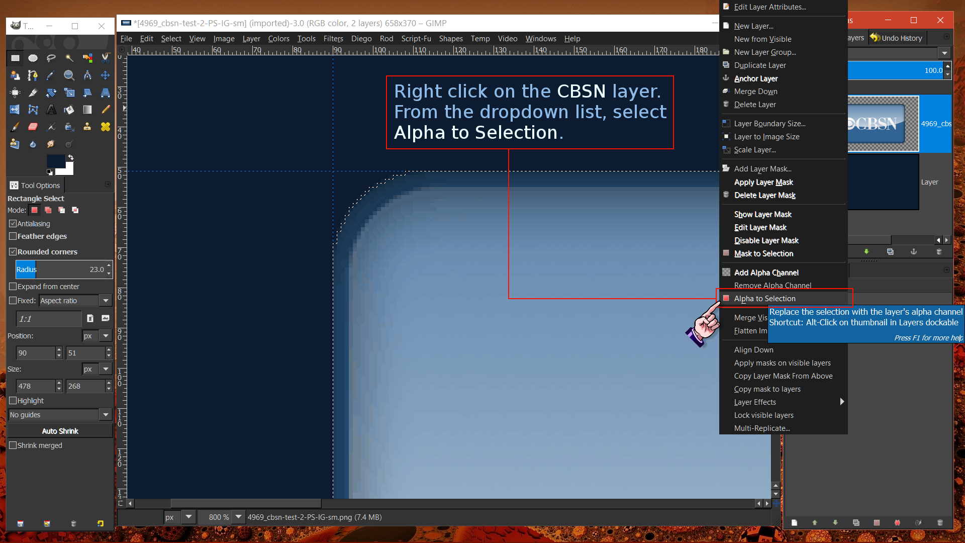

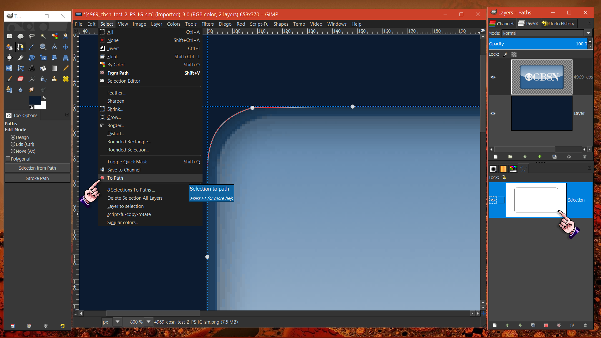

Alpha to Selection you image.
Create a path form this selection.
Stroke the path,
to create the dark outer edge.
Use optional Drop-Shadow.
My final results...
