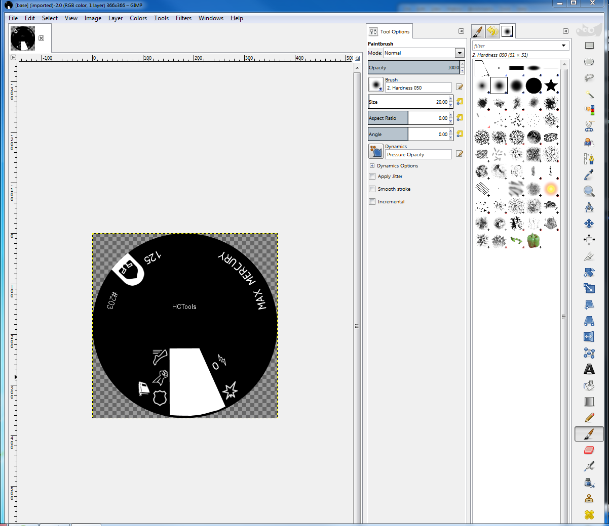

thank you for that video rich!
However, when I load up image I don't see the checked pattern behind the image. I'm guessing it's a layers issue?
I figured I had to "add alpha channel" under transparency, but when I do that it doesn't change....the background is all white

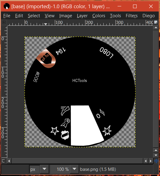

 Post subject: Re: Need help with transparency
PostPosted: Sat May 21, 2016 2:06 pm  (#14)
Posts: 14268
That's odd,
because the original image that you posted is a png image, which has transparency.
When I opened your image in Gimp.
There is no white background.
This is what I see when I open the image.

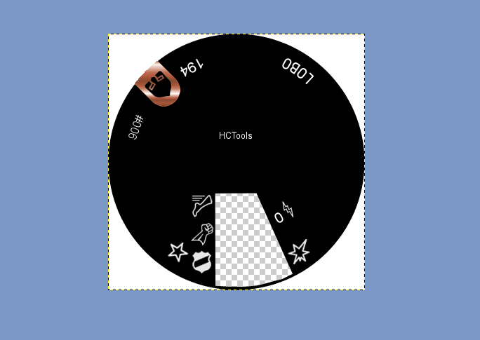

Gah!
I opened up the wrong file.
Time to watch Rich's video again :)
