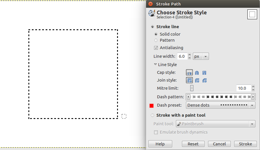

Do you need something like this or maybe you're not closing the path?
Dense dots stroke

Hiya Odinbc...I am wanting lines and as you can see the horizontal line is fine but the vertical line stays as a block. I am doing exactly the same thing for both.

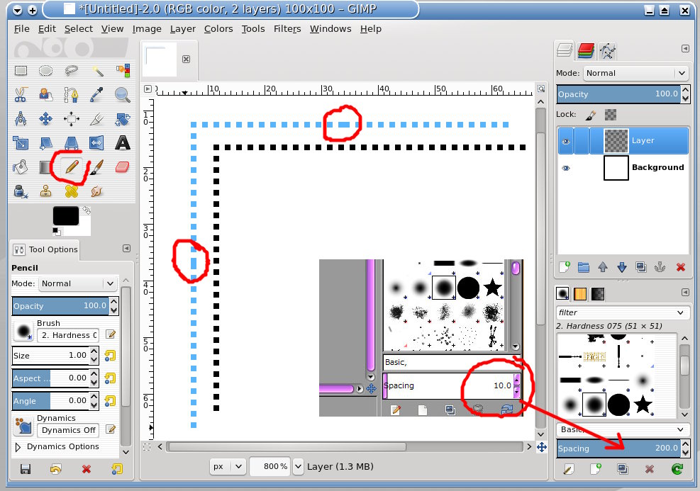

Posts: 2629
Very strange.
Can not see much wrong with the settings except, the brush spacing which is a percentage of the brush width, should be 200.
Maybe set dynamic to off.
I do find that drawing in straight lines using the shift key results in double pixels at regular intervals.
No fix, except drawing in short segments.
best way for a rectangle is still stroking a selection as Odinbc earlier post.
