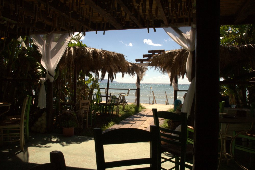

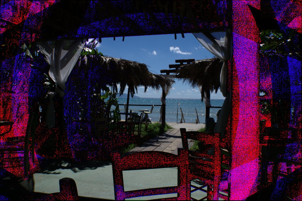

In the last few days if I try to convert .CR2 files from my camera using Gimp-UFraw I am getting very strange results.
The embedded .jpeg from the camera is OK and if I do the conversion using XnView MP it is OK.
An example of each is below. (Scaled for speed of upload.)
I have tried deleting and re-installing Gimp-UFraw and still have the same result.
I am on holiday in Greece with my small laptop, so unable to do comparisons using my desktop computer.
Any help or advice greatly appreciated.
david.

The UFRaw plugin is becoming obsolete. There are many good free alternative these days, such as RawTherapee, Darltable, etc.... Some even exist as Gimp plugins (but I still don't see what you gain from sing them as plugins).

Could be an old setting. Reinstall not much use because there is a settings file ~/.config/ufrawrc that will remain. Delete that and see if it makes any difference.

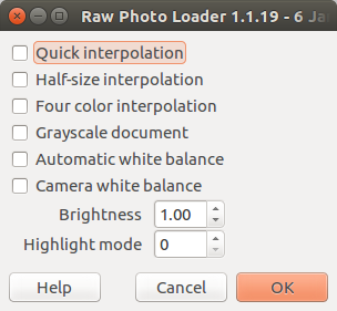

The best way to get RAW images into GIMP is (as ofnuts mentioned), Darktable, Photoflow or RawTherapee, especially since UFRaw is no longer practical. If I need to quickly load a RAW image into GIMP I use dcraw (gimp-dcraw) loader. I normally load NEF, but I've used it with other RAW formats without error. It's rarely used, has minimal options, but does the job.

Back in business!!!
I was getting nowhere with nufraw, so I deleted it and the dependencies for ufraw, then re-installed ufraw.
It has allowed me to process several photos I needed urgently, including creating a "fake" bracketed exposure for a subject where the contrast was extreme.
