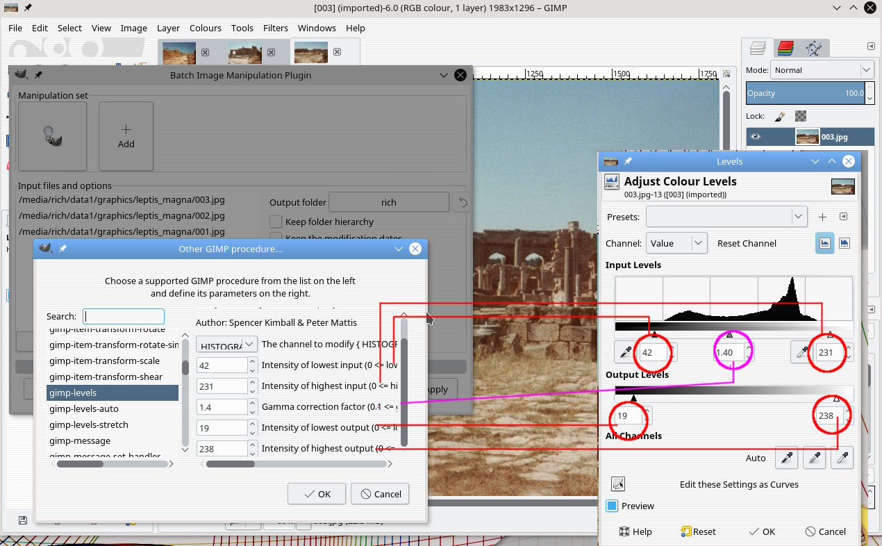

I got that plug-in batch processor but I wasn't able to find this ability in it.
Which batch processor, DBP or BIMP?
Assuming BIMP http://www.alessandrofrancesconi.it/projects/bimp/
Determine the values required using the Gimp levels tool on an image.
In BIMP
When adding a procedure choose other gimp procedure
Search for the levels option.
Fill in the values from the Gimp levels.
Apply BIMP
All-in-one screenshot showing the releationship.

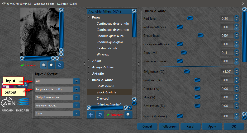

Install this filter (export_layers.py and the export_layers folder it requires restart of GIMP) They both go in the plug-ins folder.
https://github.com/khalim19/gimp-plugin ... rs-2.4.zip
This exports all the layers as the extension of your choice to a present or new directory folder.
1) Open images in GIMP as LAYERS - Edit>Open as layers
2) After GIMP opens all the images on separate layers - Filters>G'MIC
3) Go to the "Black and White" menu and select ALL for input layers and IN PLACE for output layers
4) Set your values with the slider controls and preview of your choice (i use FULL)
5) DO NOT adjust the + - in preview zoom or you'll get different results then previewed after the filter is finished running
CLICK OK
6)File>Export Layers.
7) Select an extension type (jpg, png, gif...ect) and select where to save the images
8) Select "Export Layers"
Done

How's that?
I see you suggest a 'handmade one' and then I guess a batch processed example.
Well what you've got there is a batch processed example.
There'd really be no difference whatever. The two processes the same - whether batch or 'by hand'. I simply selected the 'charcoal' filter in black and white and changed nothing. It was good as it was. Making more or less grainy was problematic. I finished up changing nothing.
I did find another method, didn't I? Or use one, rather, I didn't find it, it was pointed out to me. Using Color levels. For that one, which turned out precisely the same result as well as I can see, I found a 'black point' of 180 and a 'white point' of about 230 to be fine. Gamma unchanged at 1.0.
That method can be batch processed too using BIMP but this means teaching it another procedure and if I remember right that's where I fell down. This 'layers' method came up and I adopted it. Simpler.
