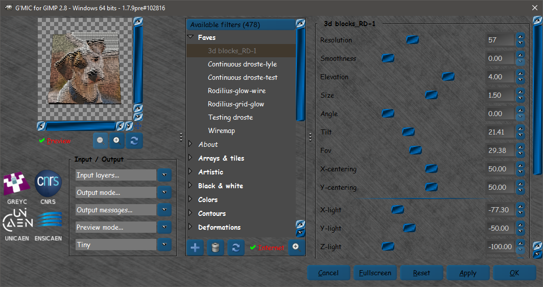

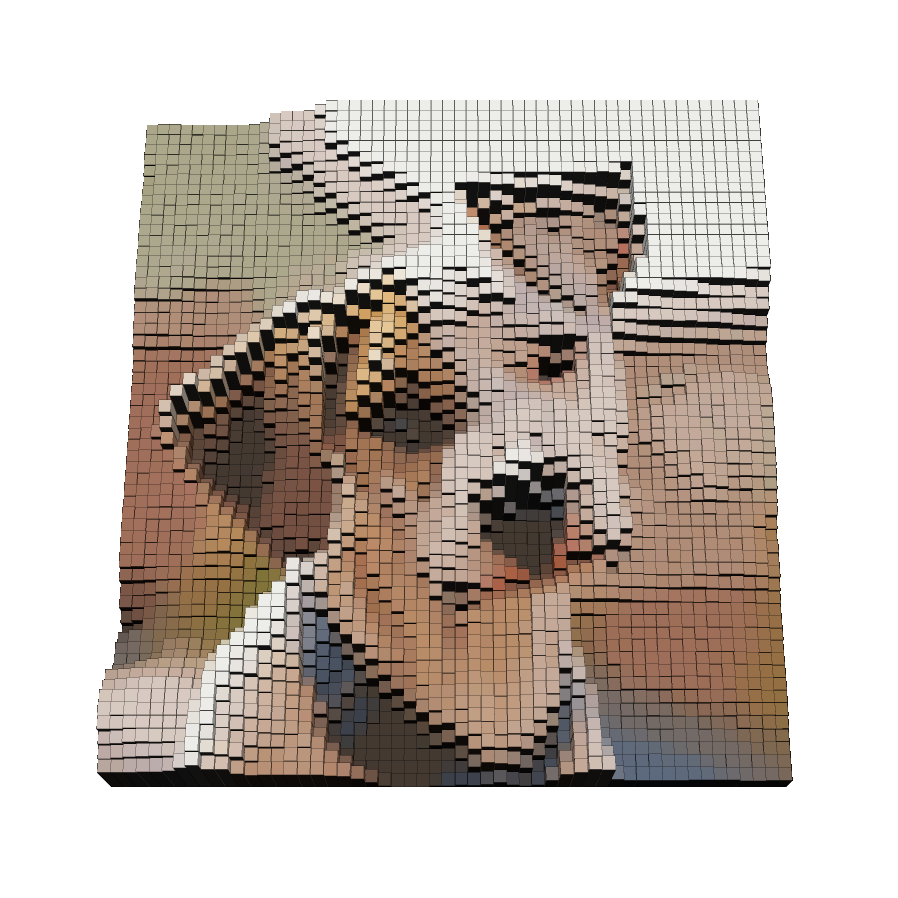

 Post subject: Re: Script that can do this ?
PostPosted: Wed Nov 09, 2016 8:16 am  (#9)
Posts: 16261
Konstantin wrote:
How about G'MIC - Rendering - 3D blocks ?
This works well but imho it has too large of blocks so i re edited the update file to 250 for resolution size rather than 128. Now i get much smaller sizes too work with. :)
open your update file in Notepad ++ and search for "3d blocks"
#@gimp <b>Rendering</b>
#@gimp 3d blocks : gimp_blocks3d, gimp_blocks3d(1)
#@gimp : Resolution = int(32,1,128) <--- change this line to #@gimp : Resolution = int(32,1,250)
#@gimp : Smoothness = float(0,0,40)
#@gimp : Elevation = float(4,-10,10)
#@gimp : Size = float(1.5,0,3)
#@gimp : Angle = float(30,0,360)
#@gimp : Tilt = float(60,0,90)
#@gimp : Fov = float(45,1,90)
#@gimp : X-centering = float(50,0,100)
#@gimp : Y-centering = float(50,0,100)
You will have to change it every time you update or refresh G'MIC though.
1000x1000 image with these settings
Seems to work well with smaller images as well.
300x300 image same settings

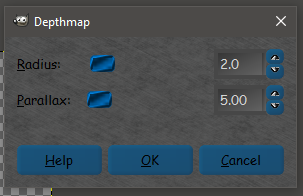

Hey i recompiled elsamukos depthmap plugin for GIMP-2.8 64 bit and tested in windows 10 64 bit
http://registry.gimp.org/node/10217
I will attach it here along with original c src file in a zip folder.

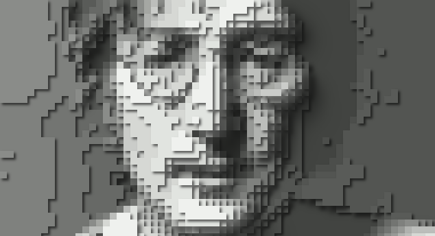

You know another neat way to get great blocks is to use Trans layer by color filter (i used 20 colors for this one) then these settings for G'MIC 3d blocks. Run G'MIC on the bottom layer in the new image that Trans filter creates.
Results
Depthmap plugin -
place in the plug-ins folder and restart GIMP.
Menu locale is Filters>Map>Depthmap.
Directions for use.
Open any image duplicate it and desaturate one. Run the filter select values click ok.
File comment: Depthmap plugin for GIMP-2.8 64 bit Windows ONLY! c src included.
