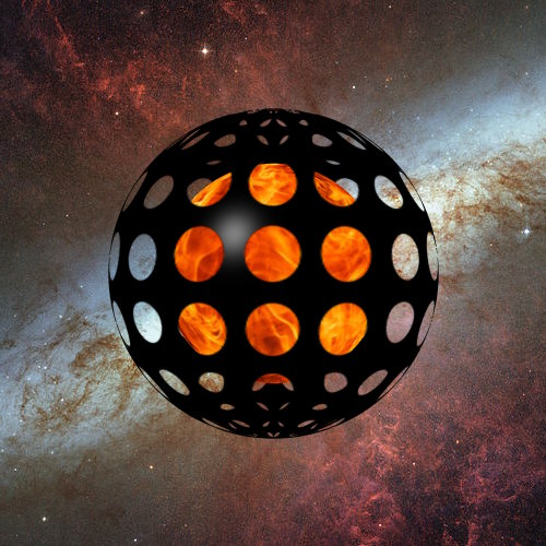

So I decided to make a grayscale sphere with holes in it, and wanted to add a ball of fire to the inside of the sphere. So far all I've been able to come up with is to manually cut and paste the insides of the holes to a new layer and to put the fire in between the face and background layers. Is there an easier way to do this? If I shortcut it and put the fire in before mapping, I lose a ton of texture and deffinition, i.e.

Possibly what you need to do is create the sphere in two different layers. Duplicate your layer before applying map-to-sphere, and make two complementary layers, one wit the two inner quarters and one with the outer quarters:
Then apply map to sphere to each with the very same parameters. You end up with a layer for the front hemisphere and one for the back hemisphere, and you just have to insert a layer with whatever should be in the sphere between the two:

Thanks a ton @ofnuts I'm gonna try that! Looks like exactly what I was trying to do, I just never considered breaking up the sphere before mapping.

Too lazy to build a background right now, but that was what I was trying to do...now I just have to monky with the technique to improve the results. Thanx again ofnuts!

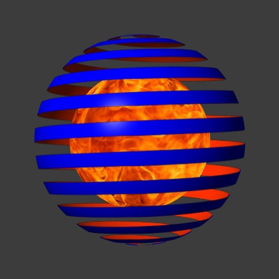

The strip extremities should match, in other words, if you put two copies of your 'flat' image side by side, the strips should be continuous. You can generate the image by bucket-fillin with a pattern that looks like this:
Then everything matches:
By the way, nothing mandates that front and back should be the same color. The "back" hemisphere shows the color of the inside:
