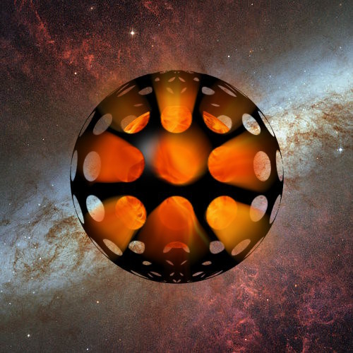

PostPosted: Fri Dec 02, 2016 3:31 am  (#7)
Posts: 14237
runSPOTrun13, good idea yours. Ofnuts gave the right idea to compliment it. Seeing his result, I thought to do this result. :)

PostPosted: Fri Dec 02, 2016 12:13 pm  (#10)
Posts: 14237
RJKD, I used motion blur - zoom - length about 80 and angle 0. Anyway I post my .xcf and you can take a look at my tut "Light rays coming out from a sphere. :) I wish you a very nice job in you project. :)
SolarJail-fire going through the holes.xcf [1.1 MiB]

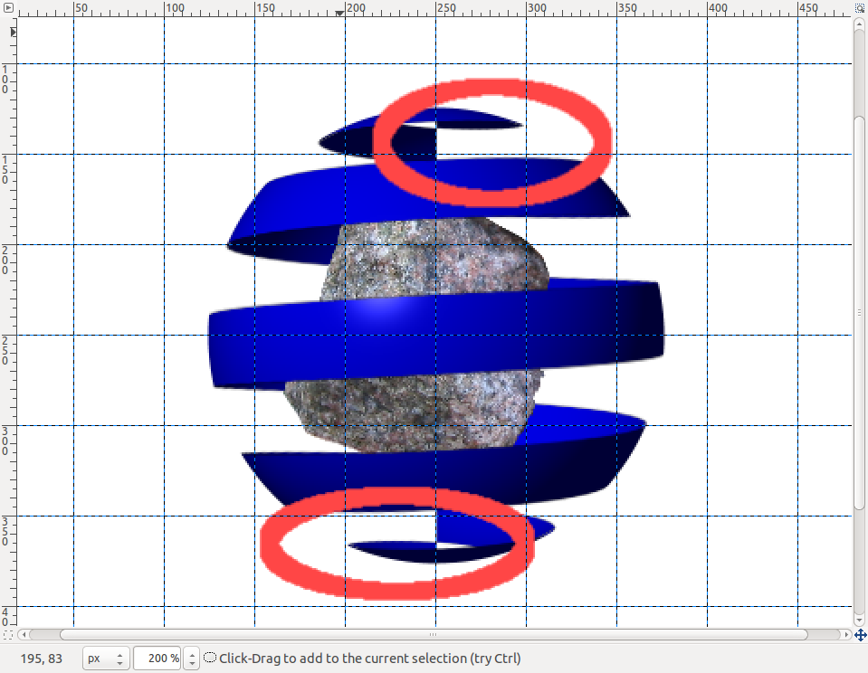

Joined: Dec 29, 2015
Posts: 223
Hi ladies and gentlemen
Is it not a problem in the mrked areas?

PostPosted: Sun Dec 04, 2016 2:43 am  (#18)
Joined: Nov 30, 2016
Posts: 34
Location: Earth (still...)
you missed a step Rashid. You're missing the bottom row of "rear" left side of image, and "rear" top row right side. It helps me to think of the pre-mapped image divided vertically into quarters...left 1/4 is rear left, middle half is front, and right 1/4 is rear right. As you can see you didn't duplicate your stripes and shift them down a row on left and up a row on right, causing a gap to appear in the mapped ribbon.

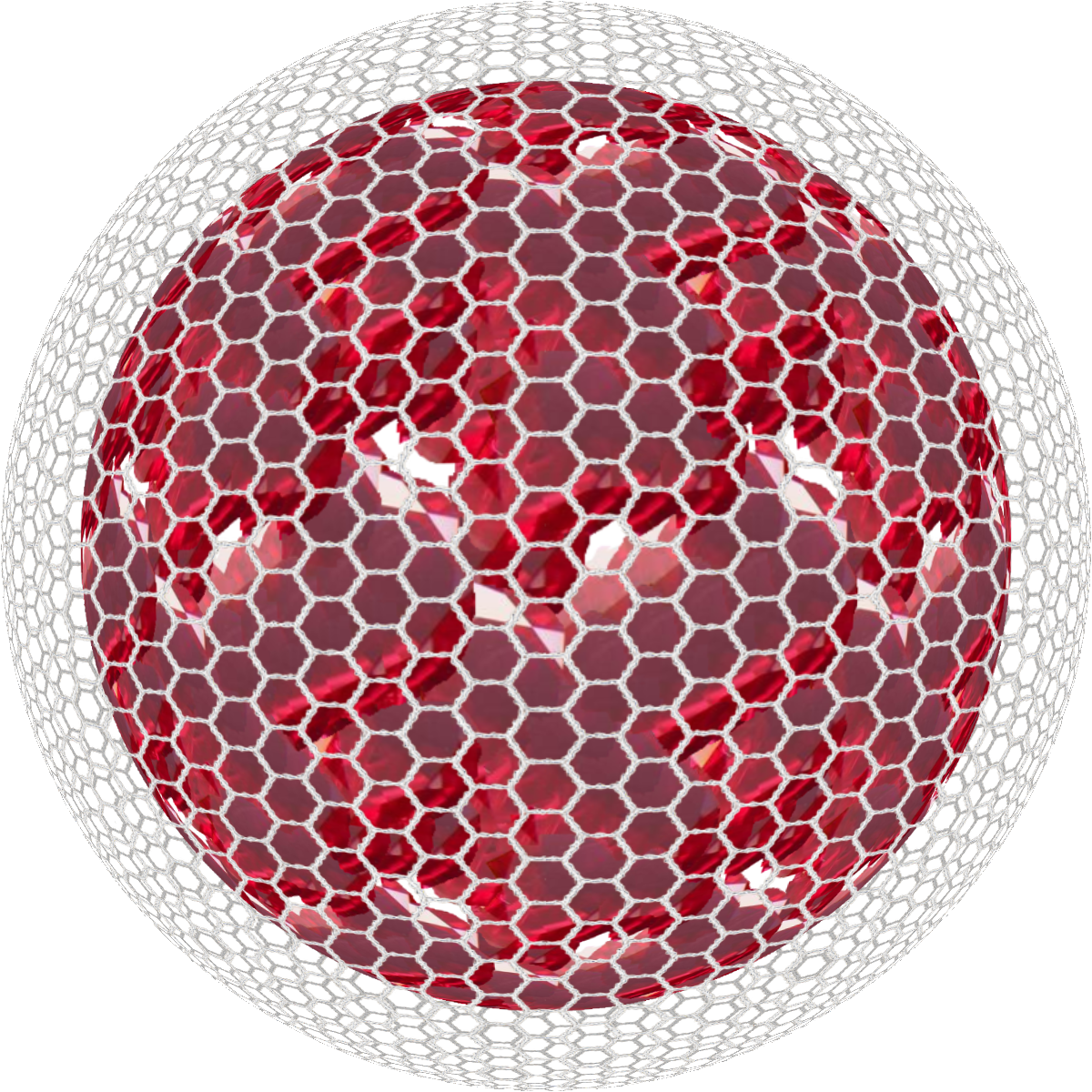

PostPosted: Sun Dec 04, 2016 4:45 am  (#19)
Posts: 223
This is what I am getting from different tutorials and your description. But the result is same...

PostPosted: Sun Dec 04, 2016 5:47 am  (#20)
The strip extremities should match, in other words, if you put two copies of your 'flat' image side by side, the strips should be continuous. You can generate the image by bucket-fillin with a pattern that looks like this:
Then everything matches:
By the way, nothing mandates that front and back should be the same color. The "back" hemisphere shows the color of the inside:
