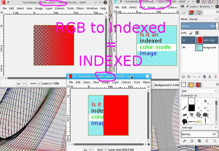

I have an image with a transparency gradient a png image, that I want to copy as a layer onto another png, but when I copy it, the gradient disappears, which went from white to transparent. Instead there is just an abrupt line where the white stops instead of the gradient, altering the image and making the attempt at transferring it as a layer unsuccessful. Any help would be appreciated.

I had to create a new image with a transparent background as the other png wouldn't accept the transparency layer of the other one... its working fine now, I just have to use the other images as layers on a new png ... then it works fine...

Posts: 2629
smoofzilla wrote:
How do I delete this post?
but do you know why?
