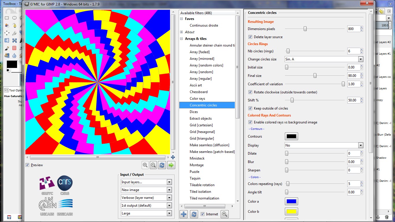

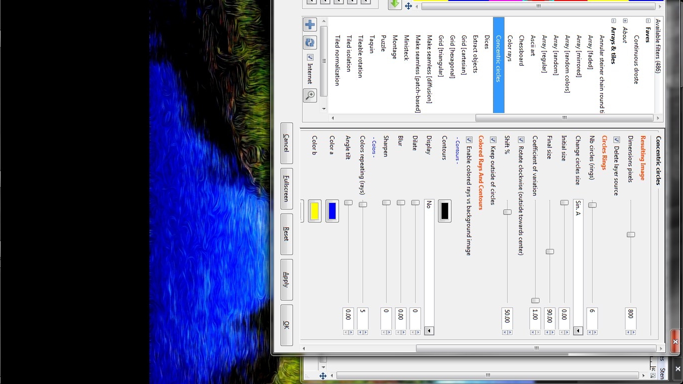

I had a problem with G'MIC not fitting on screen and me not being able to select anything off the bottom of the G'Mic screen. (eg. Ok, reset,cancel) I downloaded the file SF-Scrolling-InterfaceV1.1-For-GIMP-2.8.14-Win_x64.zip and installed script-fu.exe and script-fu-interface.c without a problem. The addition of the scrolling windows fixed the problem... for a while! Fast forward to this week and the error is back with a weird twist. I still have the scroll bar which allows me to access all of the options within the filter, but the options to activate the filter (the 'ok' button) is outside of the screen area and is not adjustable. I reinstalled G'Mic and both script-fu files. No Change. Out of desperation I reinstalled Gimp. Problem fixed... for one use. After using G'Mic one time, the problem is back. I'm at a loss. Any help would be appreciated.

This sounds similar to a problem I was having for a long time. I'm on win7, and one day realized that I had set the screen settings to "medium 125%" for easier reading. Changed them back to default and my problem went away. That is except for I can't read anything anymore. Guess it is time to get glasses.

Yeah, I saw the thing about the screen settings at medium causing an issue, but I am at default settings. Also reinstalling everything fixed the problem momentarily. I figure it has to be something ultra-simple that I am just missing. At least I know [Alt] + "O" functions as clicking the Ok box.

Thanks Muchly!! The self install of 2.0.0 worked awesomely! If I use 1.7.9, the buttons are still off the screen but 2.0.0 doesn't have the button\screen size issue.
