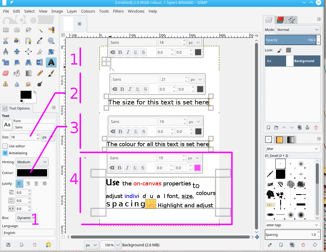

This my video (somewhat old) on using the text tool. Unlike others at least it is short.
http://www.youtube.com/watch?v=ChcTE9KROmc&hd=1
It is the same if you use the old style text editor dialog but for Gimp 2.8
In one picture, the basics.
1. You do not need to 'draw' a text box. In dynamic mode the box expands to fit the text. Just click in the canvas.
2 and 3 The tool option settings adjust all the text in any particular text layer Font, size, color, justification. This is the one you need to use, not the on-canvas properties
4. The on-canvas settings will adjust the properties of selected text.

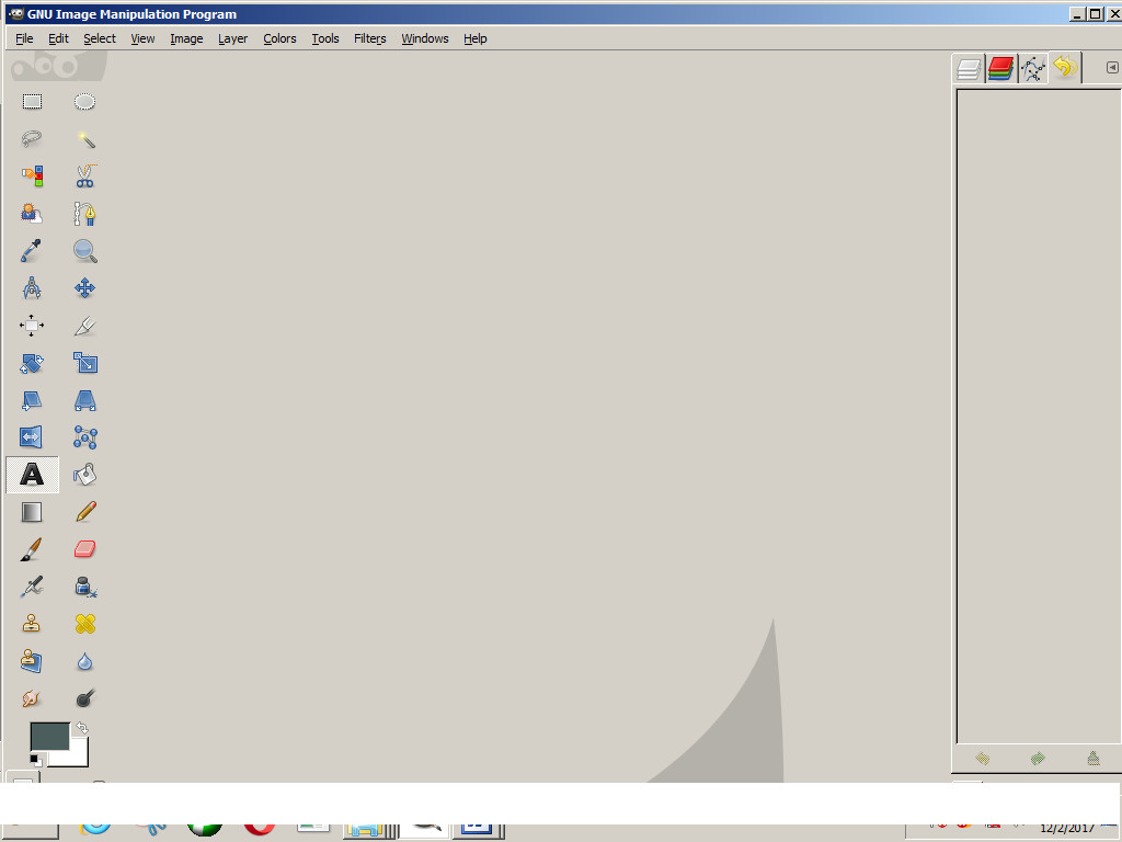

Hi Rich,
I tried watching your video.
Thank you for creating and sharing that.
When I open GIMP there is no Text Edit box which displays a Dynamic option so I’m lost at the very beginning in my attempt to ensure text is added to a graphic in a readable font.
Can you please share how I can activate that Dynamic Text box?
There's s Tools on the left in that Toolbox window but when I press on that I don't see anything new.
I’ve uploaded a jpg of what I see which is different than your screen.
Thank you!

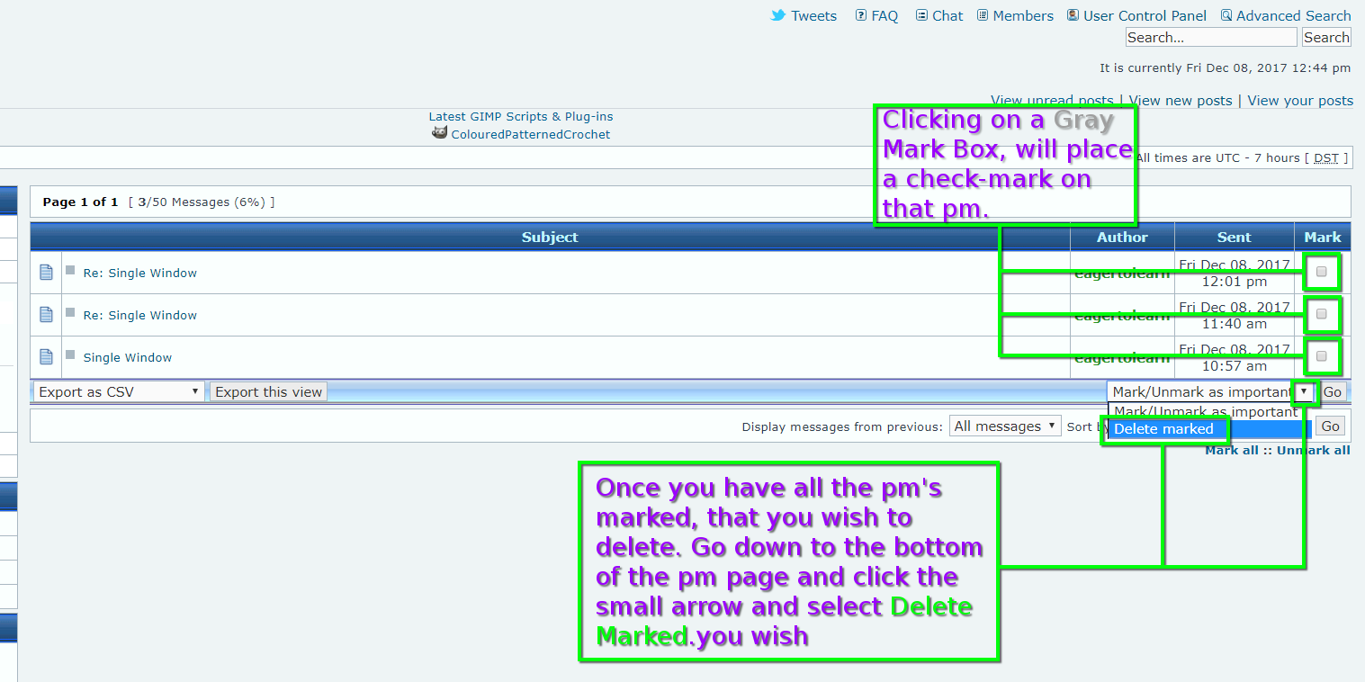

I don't see a Delete feature - how do I delete PM messages?
Thank you.
 Post subject: Re: Add Text to a jpg - GIMP 2.8.2 – Text tiny
PostPosted: Fri Dec 08, 2017 2:07 pm  (#16)
Posts: 14268
Thank you.
Put a checkmark in the small gray box in the Mark column.
Go down to the bottom of the page.
Where it says Mark/Unmark as important and expand this dialog,
by clicking on the small arrow and select Delete.
