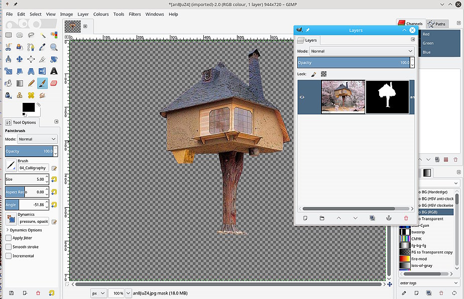

Posts: 2629
ofnuts wrote:
https://www.gimp.org/tutorials/Layer_Masks/
This is the sort of thing from that reference.
Paint in black to hide / paint in white to uncover.
There is a bit more to it, a bit of cloning to restore the dormer window and remove bits of tree from the roof.
Gimp file attached for you to improve.
tree-house.xcf.gz [850.04 KiB]
Downloaded 102 times

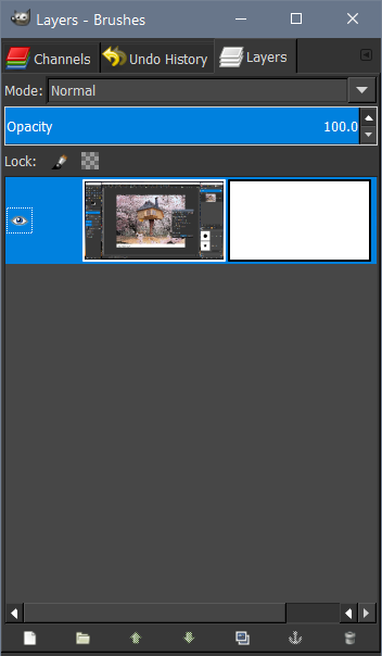

Hi,
I’ve tried my best to replicate the steps in https://www.gimp.org/tutorials/Layer_Masks/ ..but it’s just not accomplishing my goal of isolating the subject in a photo with just colors or geometric patterns around that subject.
I opened a photo (jpg) in Gimp and I can see there’s a Layers tab up top along the right toolbar. I click on that but nothing happens. I then right click on the thumbnail of the photo in that side window and a drop down menu appears where I can choose “Add a Layer Mask”.
Clicking on that opens another drop down menu with white, black, etc, at which point I’m lost. I don’t see what my next step(s) would be to create colors around just the subject of the photo (e.g. the house).
Can you please help me with this disconnect?
Thank you!

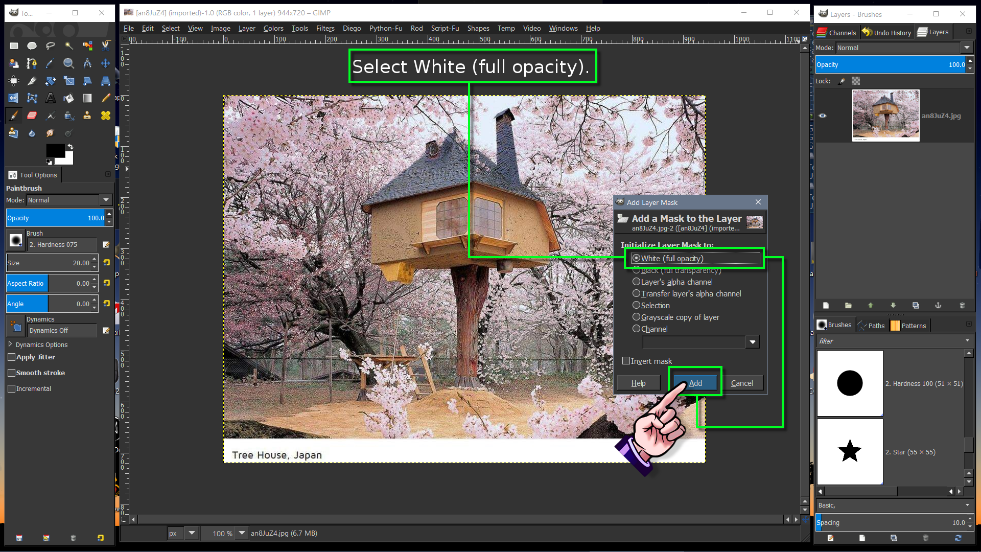

The next step would be this below.
Once you select OK and add the layer mask.
The layer dialog should look like this below.
If you select the white layer mask,
within the layer dialog.
You can begin painting with Black onto the mask.
Painting Black onto the layer mask,
will make those parts disappear,
revealing the alpha channel/transparency.
Painting White onto the layer mask will make any parts painted with black reappear.
This is typically known as non destructive image editing.

If you right-click on any layer within the righthand side dock.
A menu will open,
where you can select from a number of options,
including Add Layer Mask.
You can also add a layer mask,
by clicking Layer on the main window's menu and selecting Add Layer Mask.
When the Add Layer Mask dialog pops up.
Select OK and the layer mask will be added.
You should then see another White layer,
next/adjacent to the layer you added the mask to.
Once you've added a layer mask.
You can select the layer mask by clicking on it and then use the paintbrush to paint on it.
Painting on the layer mask itself with Black,
Will make things disappear.
Painting with White within the layer mask.
Will bring back anything that was painted black.
