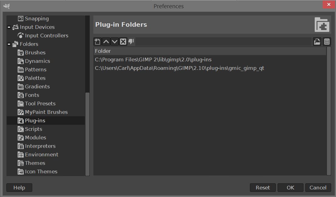

I just installed v:2.10 and I'm having the same problem. I've read everything here but can't get 2.10 to read in the g'mic filter.
Here's a shot of my GIMP plug-in folders.
I'm stumped.

Maybe you have wrong plugin entry?
IF you dropped the G'mic plugin into plug-ins folder, which in your case would be
C:\Users\Carl\AppData\Roaming\GIMP\2.10\plug-ins
You have to remove the \gmic_gimp_qt from the end.
Now it's searching the plugin from "gmic_gimp_qt" folder, inside your plug-ins folder.

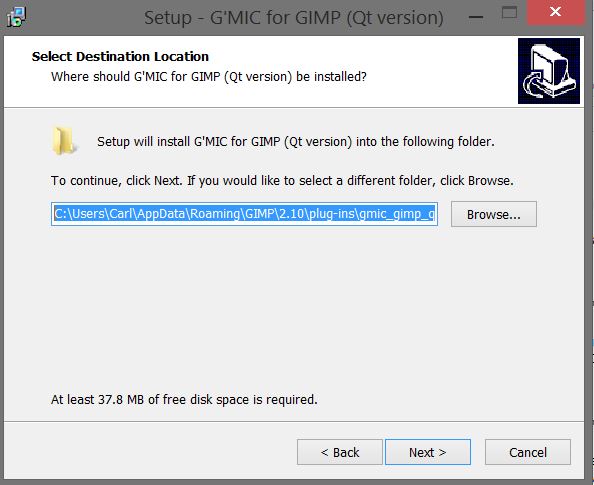

rich2005 wrote:
Blighty has a good point about the installer. If gmic was installed into Gimp 2.8 there are Windows registry entries pointing there. Gmic will look on the install as an update if gmic was never un-installed. You would need to enter the correct path for Gimp 2.10
For a clean installation gmic goes straight to the correct place:
Do you need to add to the plugins paths? No. Gimp 2.10 will use the folder name providing it is the same name as the plugin. Default paths are satisfactory.
Does it work out-of-the-box? Yes.
Here's where the gmic installer put the gmic program...

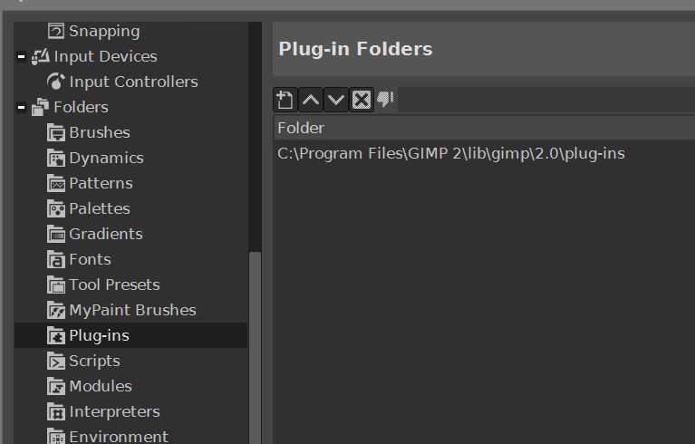

Here's where GIMP is looking for gmic...
Based on this, shouldn't gmic work???
Seems to me, GIMP is looking at the right place. Yes? No?

....Based on this, shouldn't gmic work???
Seems to me, GIMP is looking at the right place. Yes? No?...
Not the best way to do it, but of course it does work. But not in your installation. Just do not expect any other plugin you install in plug-ins to work. You have to start looking for other reasons.
Start with
Was gmic installed in Gimp 2.8 and where was it installed? Are any legacy files remaining? Especially in "Program Files\GIMP 2\..." folder structure.
Have you tried creating a clean Gimp 2.10 profile? Disable the gimp 2.8 profile (rename it) Delete the Gimp 2.10 profile. Run Gimp 2.10 to create a new empty profile. Install gmic (using the 2.10 version).
Is your Windows 32 bit?

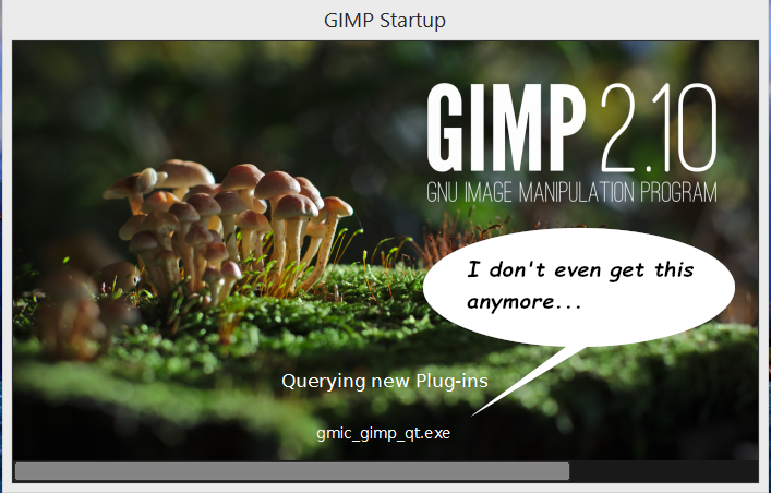

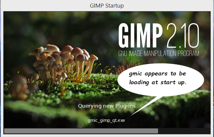

Your comment here made sense. Out of pure frustration I had to completely uninstall GIMP and start over.
I now have GIMP reinstalled. I now can get gmic to show up in my "filters" menu without using the "appdata" path.
Now gmic comes up "HALLELUJAH." But.... "there is no Dream Smoother." I was told that gmic 2.2.3 has Dream Smoother. Where do I get that? Been hunting for it all morning. Gee whiz..... soooo frustrating.

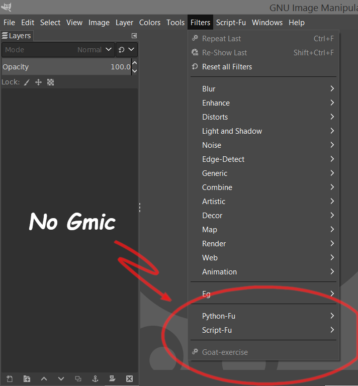

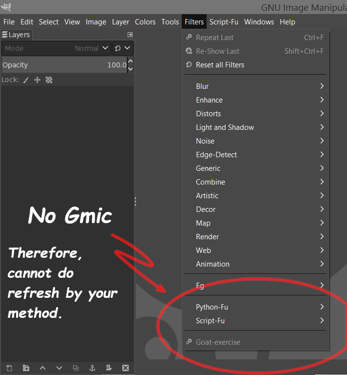

Here's the problem...
Here's the result...
I'm totally stumped as to why I'm not even seeing gmic after start up.
I have tripled checked that GIMP is looking at the right folder to get gmic but gmic is never there.

PostPosted: Sat Jun 30, 2018 1:10 pm  (#15)
Posts: 2630
Can not help any more.
What happened after this post: viewtopic.php?f=8&t=16609#p229079 edit: fixed it
You must have seen gmic then.
Why do you have that eg menu entry? (presumably egger..something scripts from some old Gimp installation )
Just do not know what you are doing.

It would save a lot of problems.
I GIVE UP...
I've been at this for three days now and all afternoon today.
I've completely uninstalled and re-installed everything to no avail.
I've tried three different locations for gmic and GIMP won't load it.
This is the result... no gmic...
This was the last location I tried...
If I want to use gmic I guess I'll just have to give up 2.10 and go back to 2.8.
Tired of messing with it anymore.
I'd still be glad to hear from somebody that might have an idea I haven't tried yet.
