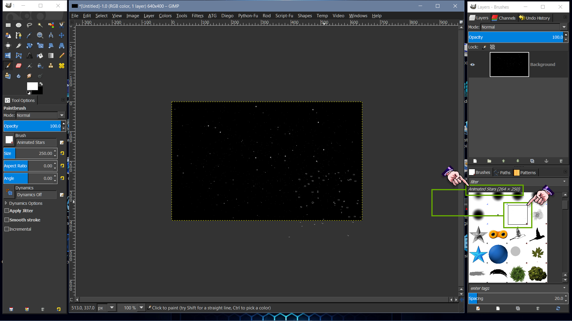

This is what the brush looks like in my brush dialog.
Take notice of the tiny red mark,
on the lower right-hand corner of the brush within the dialog.
This red mark,
denotes that the brush is an animated brush.

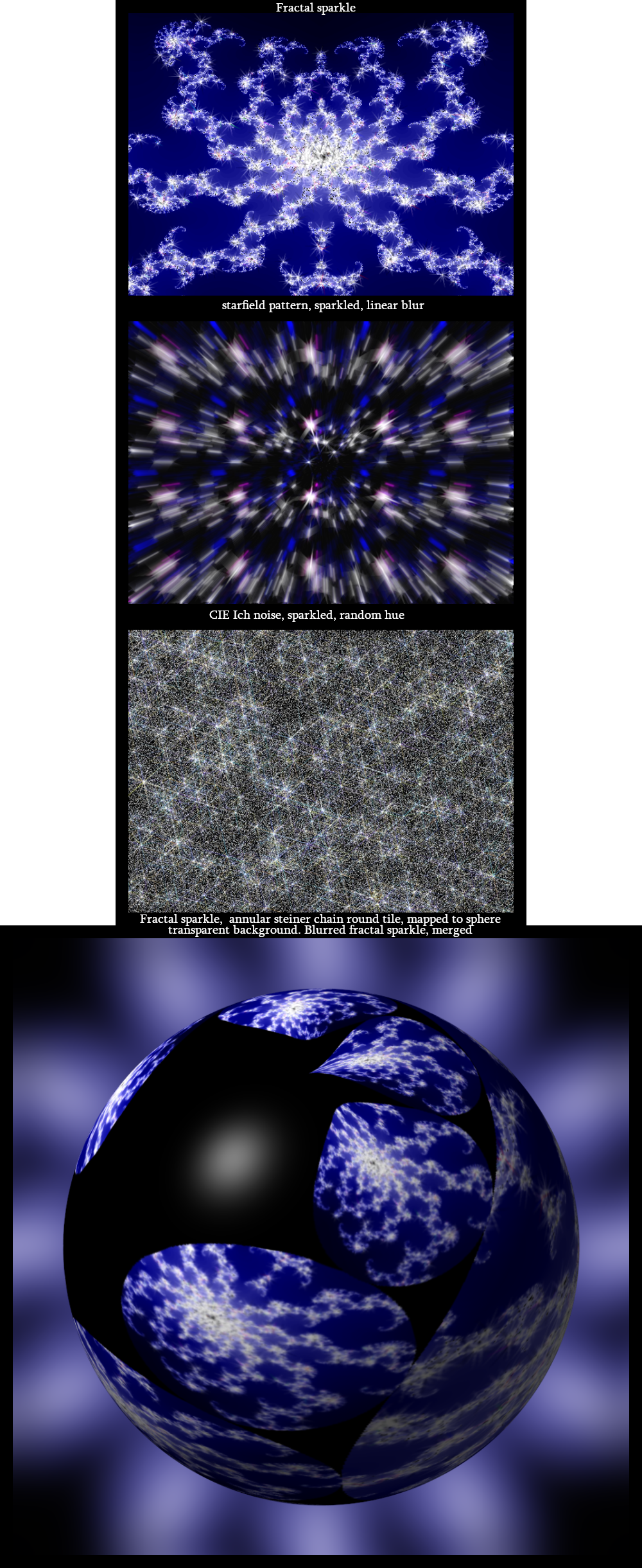

You could also try this. Do you stars with the noise then run sparkle. That should make them look bigger.
Edit: If the sparkle filter works. Mine doesn't :(

Thought I would post this here
My couple of ways to make stars
