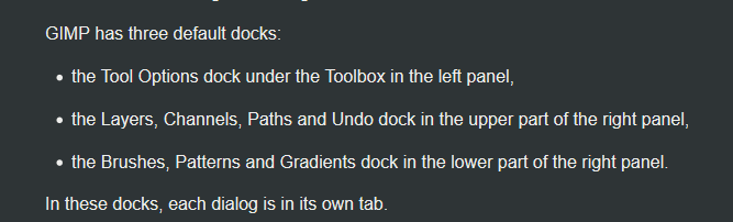

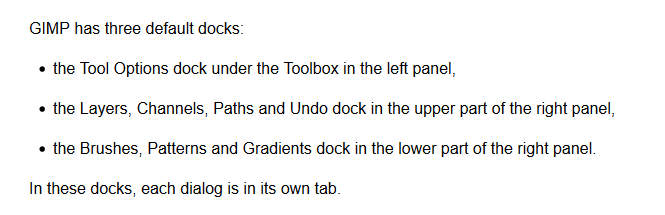

I prefer to use single window Gimp and in 2.8 it has always automatically provided 3 docks as per the Gimp user manual. This is practical as it keeps different dialogs types visible in their own dock; relevant section from the manual is shown below.
I am slowly getting 2.10.6 up and running, but for some reason only 2 Docks appear and all dialogs that used to be in separate docks are now together on the right side in a single dock, despite the manual for 2.10 (as below) stating the same as 2.8.
I may be having an extended senior's moment but cannot find a way to have the 3 docks visible. Any direction will be appreciated.

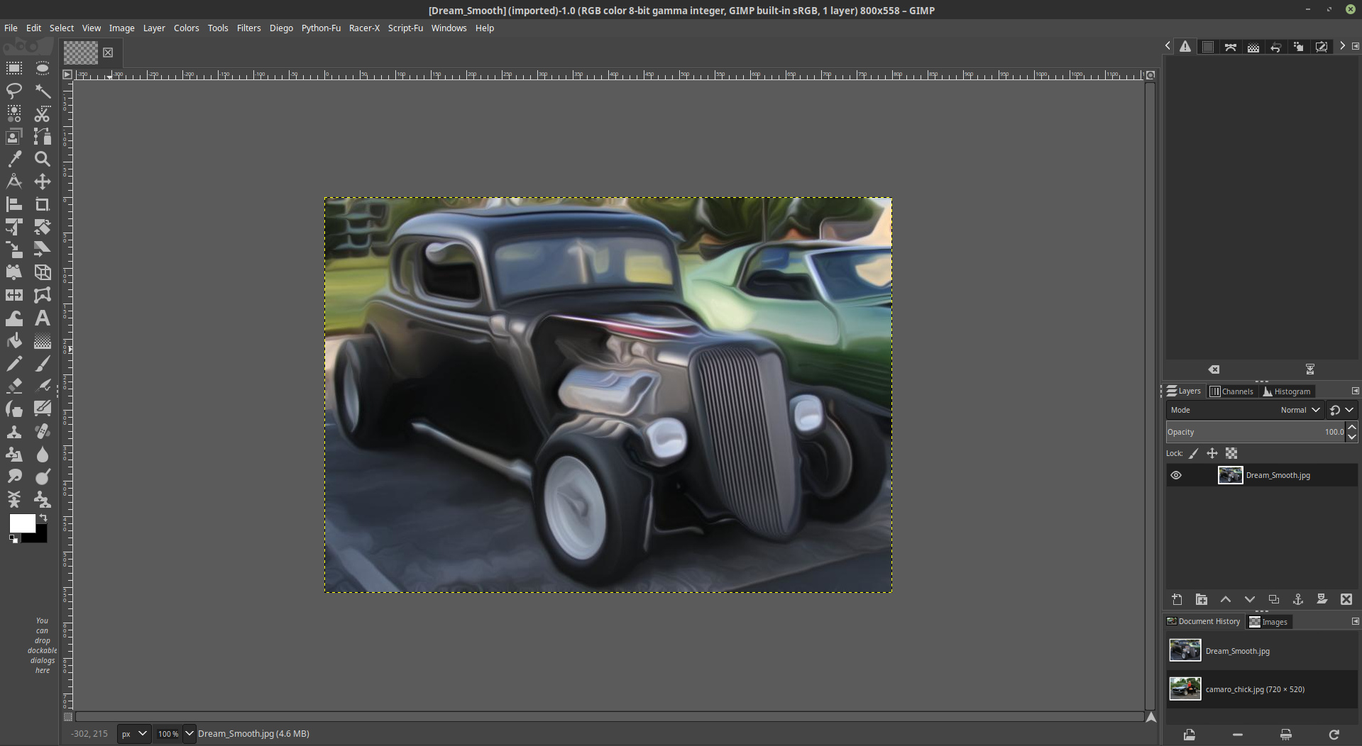

PostPosted: Sun Sep 09, 2018 4:04 am  (#3)
Mine is customized, but it has 3 docks on the right side and the tool section on the left.

For Gimp 2.10 reset the Gimp windows back to default
Edit -> Preferences -> Window Management then click on Reset Saved Window Positions to Default Values Ok that & restart Gimp.
