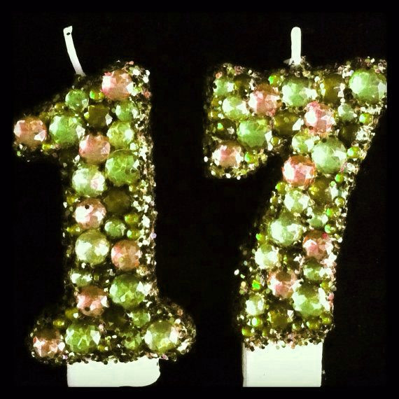

Thanks but not what I'm wanting here, I'll try to explain.
Sorry I can't find how to insert a photo maybe I'm just really dim!
Think I've done it in a messy way!
This is the photo I'm trying to edit, for a bit of fun and maybe a card.
If I go colors->Hue-Saturation and put the hue up a bit (50 on the scale) I get this:
Now if I revert to the original and repeat the process but put the hue down instead of up I get this:
Now what I want is to like zoom in on the rainbow of hue and then display the result as a larger section of the rainbow so that the gold becomes green while the pink becomes violet, get me now?
Is this possible in GIMP?
Thanks either way!
Danny

Always better to give an example of the image.
You could try Colors -> Map -> Rotate Colors although for red -> violet and gold -> green requires using the filter twice.
Gimp 2.10 has a split view (new/old) so using that:
1. red -> violet
2. gold -> green
