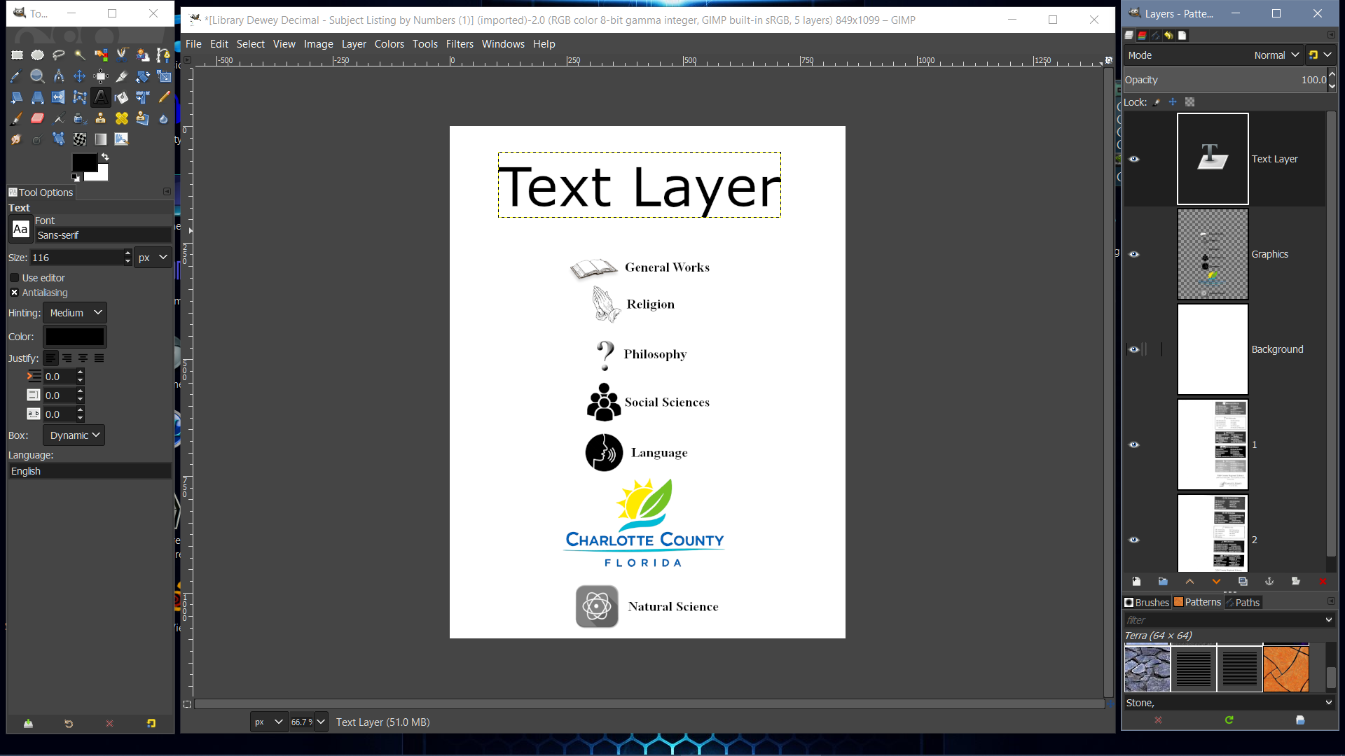

If you want to upload a PDF file.
Use the File Uploading Attachment Dialog at the bottom.
I put this image together (seen below) for you.
You can open your PDF within Gimp.
Create a new layers above the pdf layer,
to place your graphics on.
Select the Text Tool :text and begin to type some text.
 Post subject: Re: Translucency - removing colors in a background graphic
PostPosted: Tue Jan 22, 2019 1:21 pm  (#7)
Joined: Feb 26, 2014
Posts: 248
Hi Wallace,

The PDF and the images contained therein,
are of low quality and not in good shape.
It would seem batter/easier to create an entirely new brochure.
1. Open the PDF file in gimp.
2. Right-Click on layer 1 and select New Layer.
This will create a new Transparent layers above all layers.
3. Fill this new layer with white and name this layer Background.
4. While still on the Background layer,
select the Text Tool :text and begin to type within the text box.
This will create a text layer above the white background layer.
5. Add another layer for your graphics to be placed on.
Move Graphics layer below the text layer,
if required.
The layers containing the PDF information can be use for reference,
or they can be deleted, because the're no longer needed.
With these layers added.
The image should look something like this below.
Export the finished file as JPG,
because transparency is not needed.
Exporting the file as a PNG image,
can retain the transparency.
However,
your image will have a white background,
so transparency isn't required.
