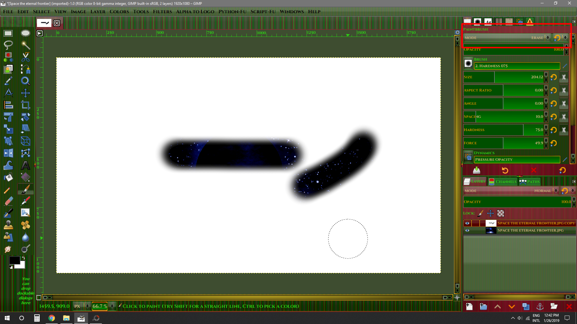

Hello, I am new to the program and digital artwork and I am trying to figure it all out on my own. I have an issue I really need help with ASAP, it only just happened and I'm not sure if I did something to cause it. If I try to draw on a layer that is over top of a background i created or an image i added as a layer instead of giving me a solid coloured line it just creates a transparent line that shows the layer underneath. I am unable to figure out what is going on, any help would be greatly appreciated as I am unable to do the work I was trying to do now.

Hi GW92. I'm trying to recreate what you did. Check the on the Brush option "Mode" if is in "Normal". When you have this Mode option on "Erase" it will give you a transparent line.
That is EXACTLY the problem!!
