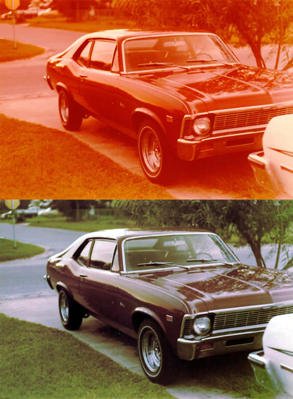

You could try this old plugin as a starting point. ColourNegativeInverter.py - attached, unzip, pop into plugins folder.
The home page is long gone: http://www.rayadagio.de/manufacture.html
Example is some ancient negative I just pulled out and scanned in a regular flatbed, so not wonderful ;)
1. The plugin. Colour pick unexposed orange and turn off Auto seems to work best here. https://i.imgur.com/1qAUIFY.jpg
2. Which gets me to this: https://i.imgur.com/O576Jzy.jpg
3. Levels, Auto Input Levels, gets to this. https://i.imgur.com/ijoTt5N.jpg
Best of luck.
