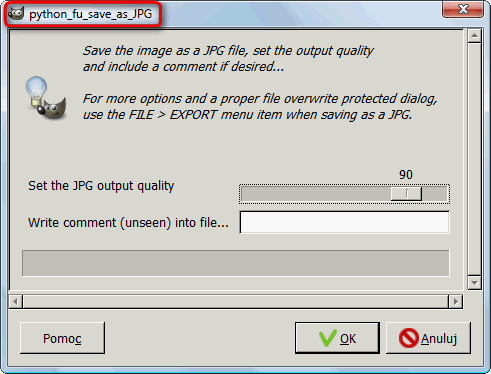

I can not check in GIMP 2.10.8 (I have only 2.10.5) but in my opinion it is additional python plugins (Save as PNG, Save as JPG).
This comes from GIMP 2.8 (but works fine for me in GIMP 2.10).

Sallyanne, I have presumably the same setup [a recently reinstalled 2.10.8 and Windows 10 Home] but the jpg and png save options do not appear in the menu.
 Post subject: Re: Am I the only person this does not work for?
PostPosted: Sat Mar 02, 2019 7:51 am  (#5)
Posts: 2629
Paul Sherman scripts from http://www.gimphelp.org/script210.html
about halfway down the list: 210_save-as-jpg.scm / 210_save-as-png.scm
..Edit: Just tried it again. saving an already saved picture works - a new picture however doesn't - to either jpg or png
New image, probably find it in C:\Users\'yourname' The png as untitled.png and the jpeg as jpg (no extension)
Very flaky, best removed.
