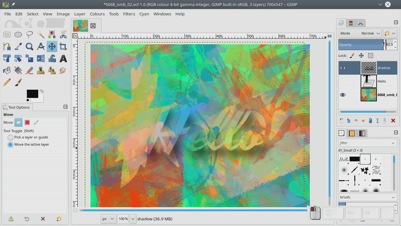

Is this what you are looking for?
I used Drop Shadow (legacy) on the upper layer. The Drop Shadow layer can be moved to suit your needs.
DropShadow.xcf.gz [813.19 KiB]
Downloaded 135 times

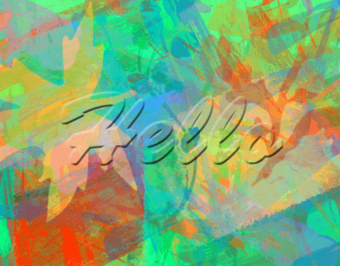

Maybe something like this. Not straight forward when the text shape is a cut-out. Too much blur and lose the edges.
2 minute video: https://youtu.be/kPBpjApAnZw

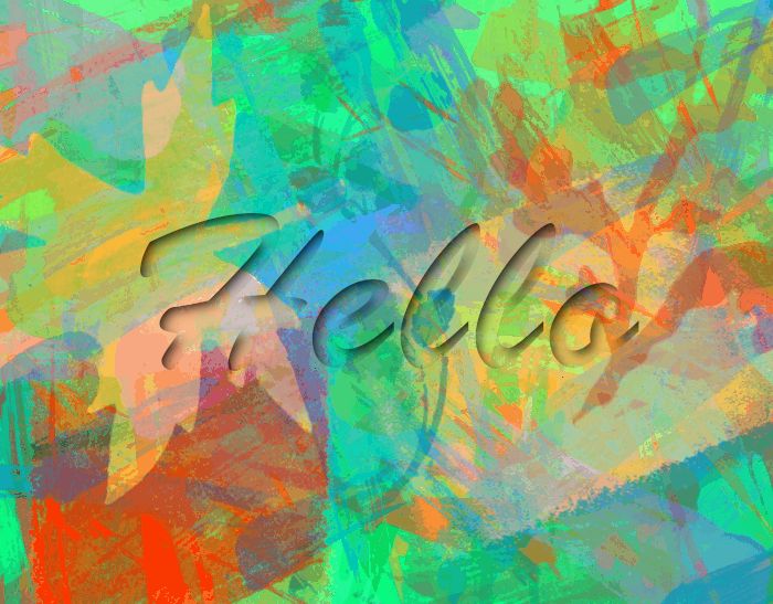

I had to give it a try.
Mine is pretty easy.
I made the text layer and then the text layer to image size.
I used Layer Effects > Bevel and Emboss and used the defaults on the text layer.

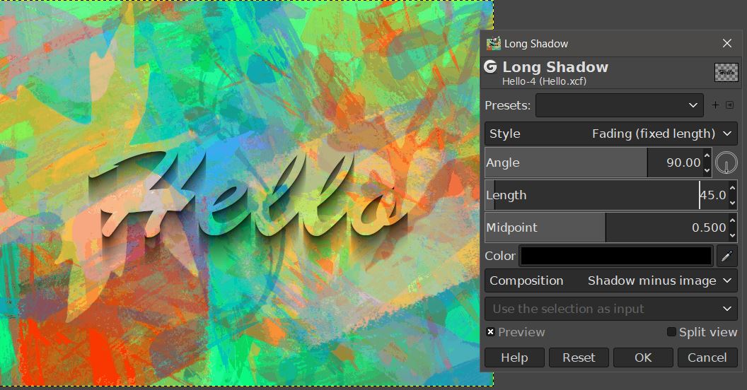

When it was done I made the text layer invisible.
Have you tried Filters > Long Shadows ?
Under Composition on the filter you can select Shadow minus image.
It might work for you.
Hello.7z [354.35 KiB]
Downloaded 120 times

I was going to suggest making more than one shadow each on a separate layer with different amounts of blur and opacity. I used two here:
but I prefer your long shadow tips SeriousTom and rich2005, I hadn't noticed that filter before.

TomSerious, thanks for the xcf file and your screenshot because I did not see the option "fading (fixed lengh)Image
one last thing, I do not remember how to give a name to the setting of the long shadow (or other) ...
