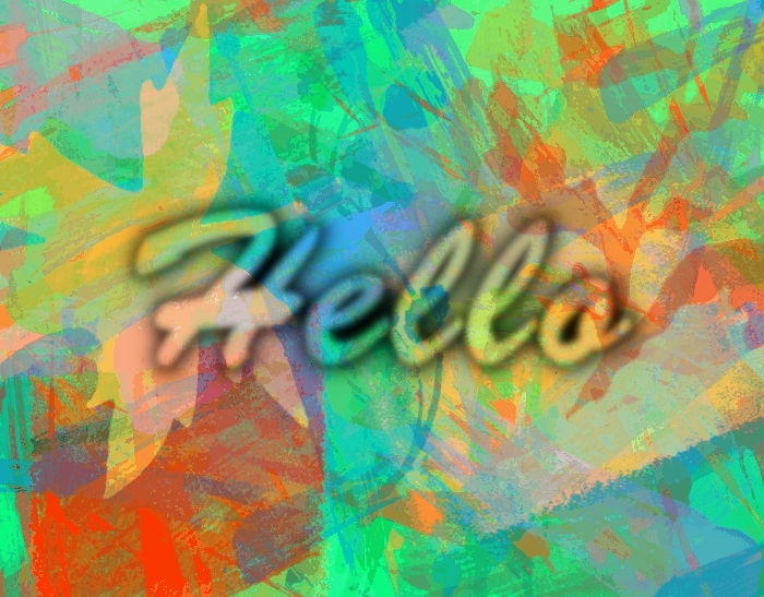

I just smear a background to explain it better. I made a selection of the word "hello" (then I cut and pasted as a new layer):
As we do not see well on the screenshot, I have dark (but I would like to make a gradient shadow without darken the word "hello")
so how to make a gradient shadow that starts from the outline of this word?
