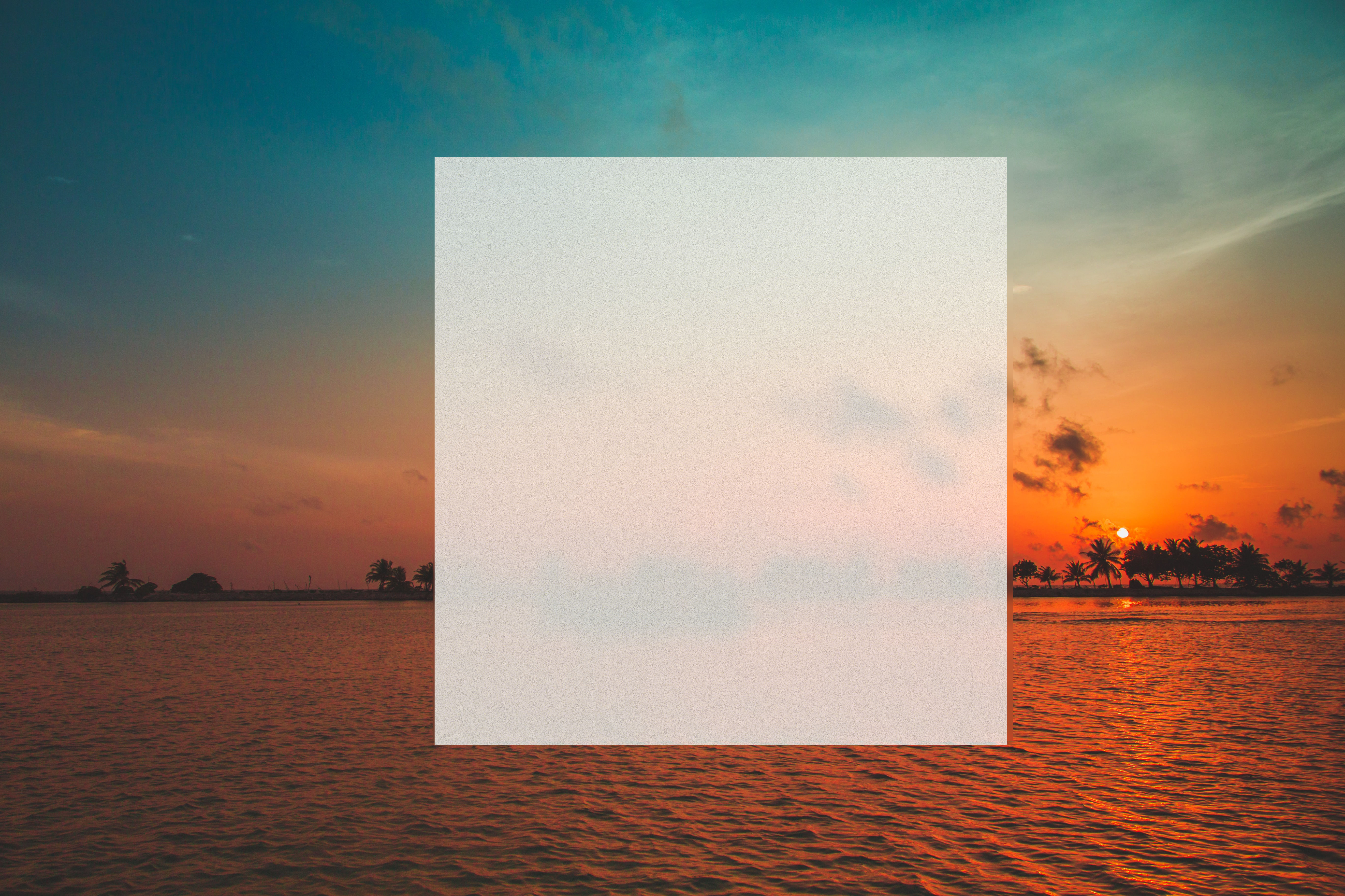

Testing with a random wallpaper

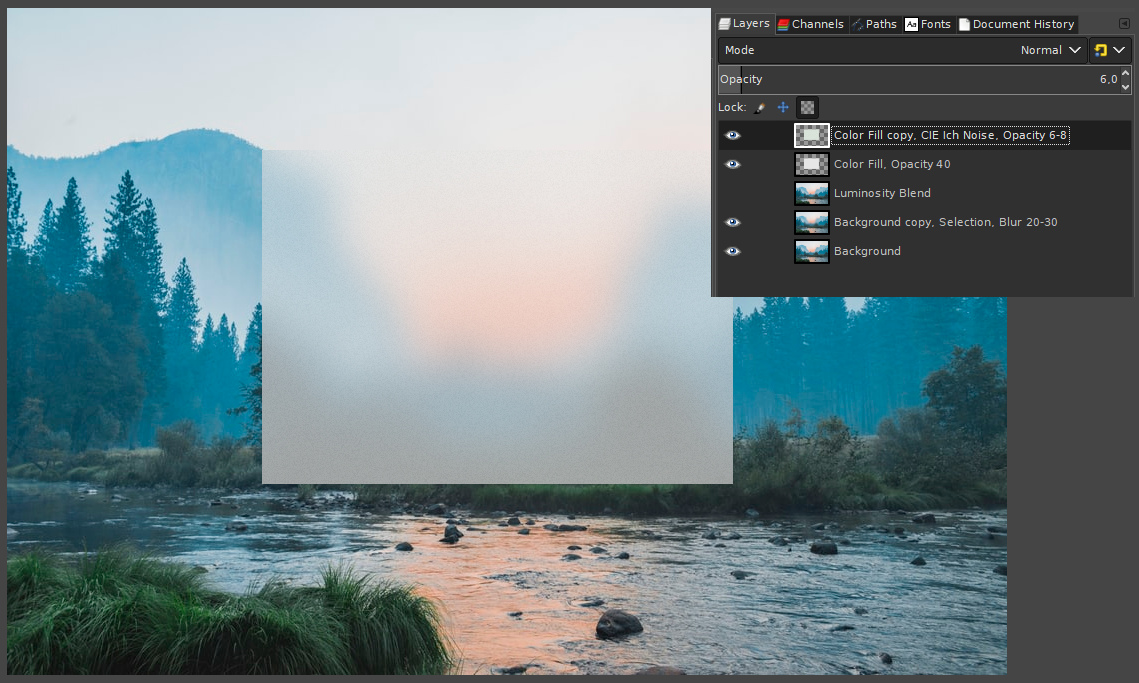

You'll find exclusion blending mode if you go through them.
Here's the layer structure I used for the first test, it's not same and could be better. Gotta try more later.

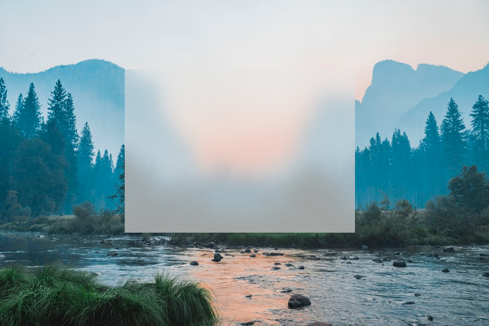

Awesome. I forgot about the noise filter. Let me try.
Update :
It works, thanks. But how do we use them on logos ? Such a mask will make the logo almost invisible.

For logo, I created a new layer over the selection and filled it with white. Then applied Noise to it and set opacity as 8 for small sizes and between 6-8 for normal canvas. It now has a soft matte finish now.
