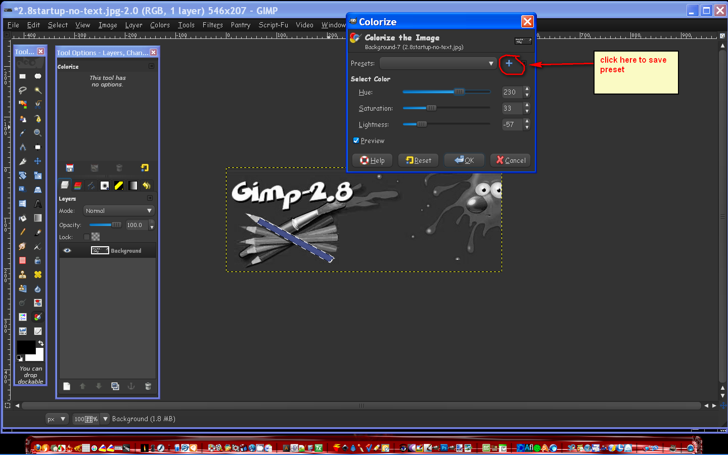

You said you wanted a color focal point.I assume you mean a color used only on one or two areas?
If the results you want are something like a color pop image like this -
It's very simple to just take your selection tool (free select), and select the area you want colored.
Feather that selection by 2-3
Go to Colors/Colorize and play with the 3 settings until you get the color you like.
Then if you want to re-use that setting save it as a preset in that same colorize dialog.
