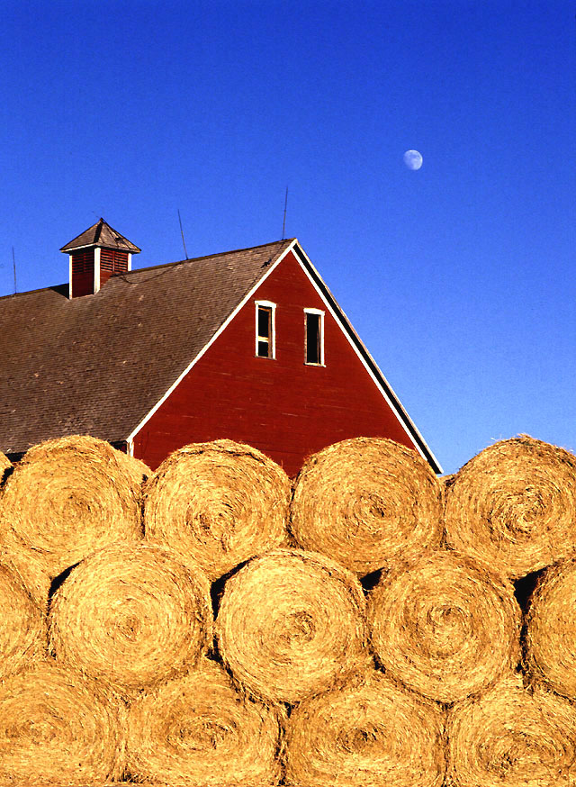

Does this kind of results suit your needs ?
Original:

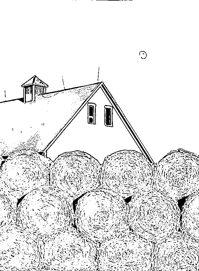

Result:

I made it this way:
  • Apply "Comic book for 2.10" filter (= my "photo to cartoon" plugin)
  • G'MIC -> Colors -> Curves (Colorspace=Lch) : lower Chroma to 0 everywhere, add a point (32,255) on Lightness

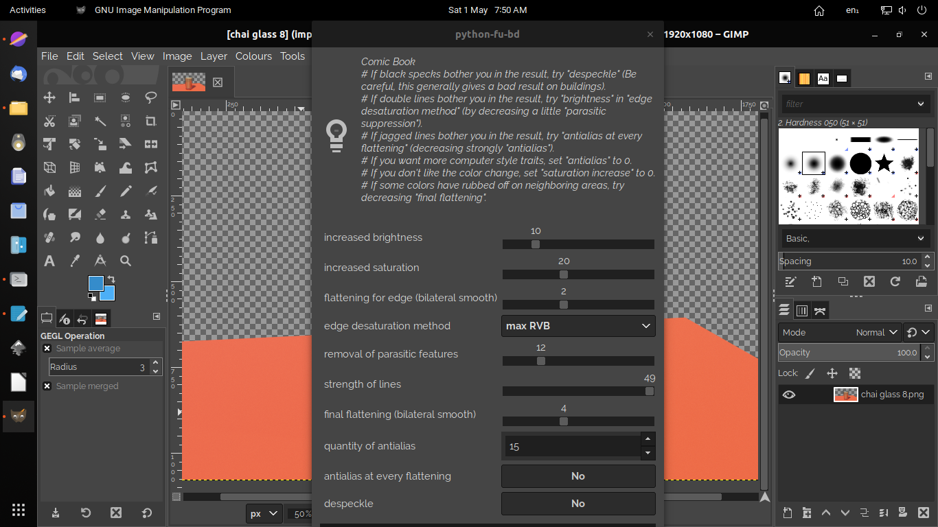

Joined: Nov 19, 2019
Posts: 209
cli345 wrote:
The French version is on my github (see signature) (for Gimp 2.8 and 2.10) (Gimp gets it in Filters->Artistic->Bédé).
The English version (translated by Nidhogg) is here (for Gimp 2.10 only) (Gimp gets it in Filters->Artistic->Comic book for 2.10).
Enjoy! :)
Thanks. But I am unable to use because the menu is too tall and extends beyond the Window
