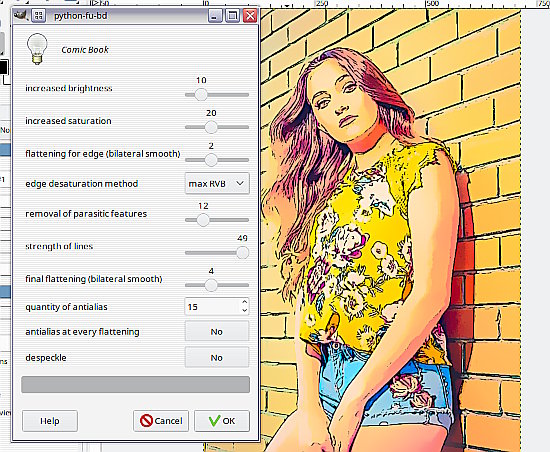

Thanks. But I am unable to use because the menu is too tall and extends beyond the Window

Here is a less tall version:
(Warning: this is not a zip file, please remove the 'zip' extension)
bede2.10.py.zip [4.27 KiB]
Downloaded 144 times
Thanks. I added bede2.10.py to plugins folder, but there is no entry in Filters > Artistic like before.

rich2005 wrote:
Did you:
Rename the download bede2.10.py.zip (4371B) to bede2.10.py
Using Linux ? Make it executable.
Thanks. Making it executable works. Sadly, it works but throws an error as seen below
Traceback (most recent call last):
File "/tmp/tmp.XJYXAxRbvA/gimp/2.0/python/gimpfu.py", line 740, in response
dialog.res = run_script(params)
File "/tmp/tmp.XJYXAxRbvA/gimp/2.0/python/gimpfu.py", line 361, in run_script
return apply(function, params)
File "/home/veed/.config/GIMP-AppImage/2.10/plug-ins/bede2.10.py", line 34, in bd
pdb.plug_in_gmic_qt(img, layer, 1, 0, '-fx_curves_interactive 7,0,1,7,0,0,'+pointLum+',100,100,-1,0,0,'+pointSat+',100,100,-1,0,0,100,100,-1,0,0,100,100,-1,')
RuntimeError: cancelled

Which version of G'MIC do you have ? (You need the 2.9.7.)
 Post subject: Re: Photo to simple Pencil drawn
PostPosted: Sat May 01, 2021 10:57 am  (#19)
Joined: Nov 19, 2019
Posts: 209
I am using the 2.10.25 App Image with plugins -version.
How can I check the G'MIC version ? Thanks
PostPosted: Sat May 01, 2021 11:15 am  (#20)
Joined: Apr 19, 2021
Posts: 138
See G'MIC -> About -> Release Notes.
