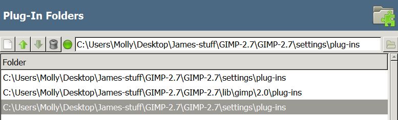

I don't have any problems installing G'MIC to Programs but I can't get the newest verson of G'MIC into the portable version of (James) Gimp 2.7
I looked in preferences under folders > plug-ins) This is what it shows. Do I install it into one of the ones below?
 Post subject: Re: g'mic constantly re-installing when Gimp restarts
PostPosted: Wed Sep 07, 2011 11:03 am  (#12)
Posts: 16261
If you install it into any one of those directories Molly it should work.
Gimp should be able to initialize it anyways.
PostPosted: Wed Sep 07, 2011 11:43 am  (#13)
thanks, I will give it a try.
Edit: tried both and I still have the 1.4 version in Gimp 2.7 and it won't fresh any new plug-ins
