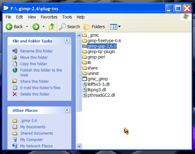

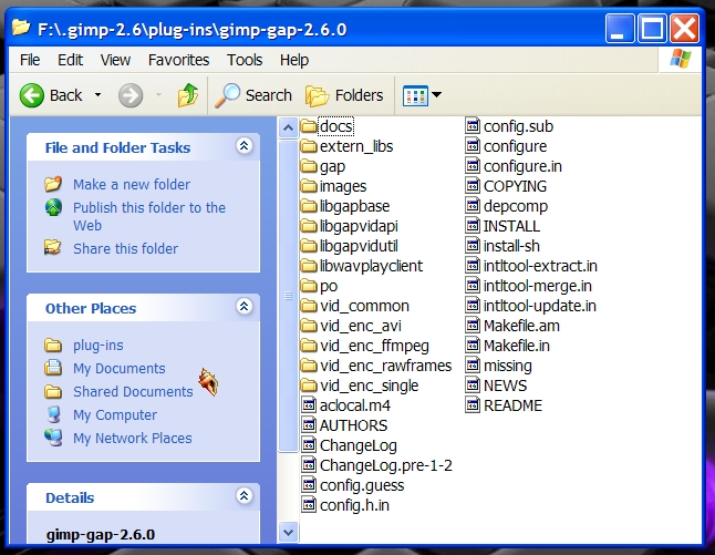

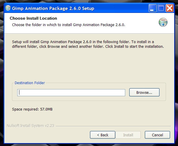

Gimp is on my storage drive F instead of C so I opened the packager but it did not "find my 2.0" folder as the post on tutorials notes. I can find no "plugin" folder in gimp 2.0. In the screenshot below you can see that the install to line is blank so I installed to f/gimp-2.6/plugins and it seems to have deposited all the folders but GAP does not show up when I open gimp. I did the same for perl, freetype and lqr. None of them show up when I open gimp. How can I correct this and get everything to work.

From what i may see there are 2 big problem each sufficent to screw up the install
1) that on screenshoot 3 .is not GAP for windows but the source code.
As far i know GAP for win is downloadable only from my pages on DA (photocomix_resources user on Deviantart.com)and from JamesH blog (that is in Chinese so few get there )
2) the plugin folder
You don't need to know where is the plugin folder
Just create a new folder where you like (well in F but for the rest where you like) put the all the exe of gap there.
RIGHT click on 1 of the exe, go to propriety, COPY the path
LOAD gimp go to Edit/Preferences/folder/ plugin, click there new folder icon PASTE the path..and don't forget to click ok
GAP contain also 2 scripts (.scm) do the same (place in a new folder paste add the path in preference this time will be .../folder/script )for the script
What i described is the BEST way to install everything in gimp from patterns to brush,i will do the same for GMIC and Liquid resize (each in its own folder )
the other plugin (that included in a single exe file) may be dumped all togheter in the same folder..A dedicated folder is better for "complex" plugin,(that have each several different files )

Weird looking better the installer you show IS for windows!
BUT the thing you installed look as the source code (and no the GAP installer can no install the source code )

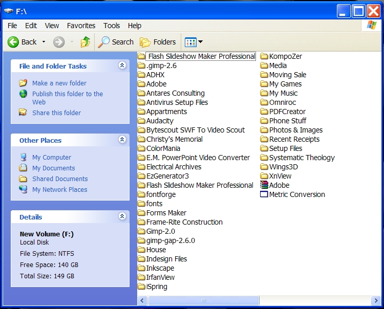

I'm old and slow and having some difficulty understanding all your instructions so please bear with me. First, I did download the windows version from deviant art. In the first screenshot you will see when I right click on the setup file it shows the description of the file.
If I understood you correctly, I install directly to my F drive outside of gimp entirely which shows up under my gimp 2.0 folder in the second screenshot.
The third screenshot is what the setup/install program deposited in that folder. Assuming I have done this correctly so far the next few steps are where i'm a little confused.

you should have tried before to install gap:
What you show in the last image is the GAP code not what the installer should install.
So no surprise there are no exe there , exe are a Windows thingy , but that is not something for Windows .(not even for Mac or Linux, it is the uncompiled source code )

OK. I guess it's back to square one. I'll go to the deviant art site again and try to download the right one.

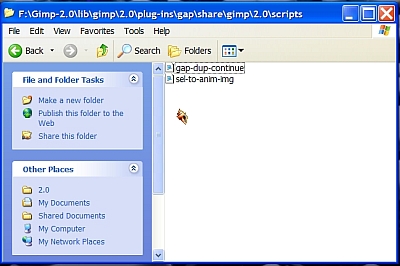

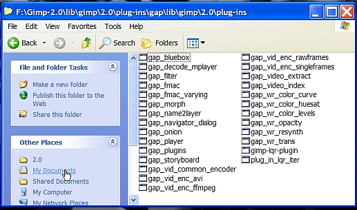

This is really becoming annoying. I still can't get it to show up in the menu bar.
One other thing...do I need to delete the install program like I had to do with GMIC to get it to work?
Here's how everything as it is installed now.
 Post subject: Re: Gap not showing up
PostPosted: Fri Sep 02, 2011 8:22 am  (#17)
That second shot is a script folder and those two files in there don't look like scripts. They should have a scm extension.

ALL my gap is in C:\Program Files (x86)/GIMP-2.6.11/lib/gimp/2.0/plug-ins.
I have one gap file in scripts and it is gap-dup-continue.scm
