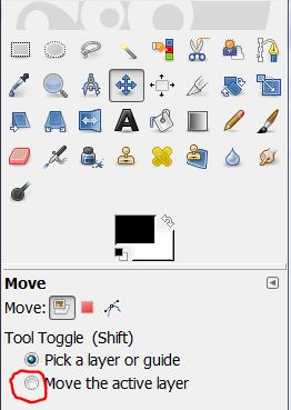

Were you trying to move this with the move tool? If so, make your you click where it says move the active layer.

Molly,
Yes i was trying the move tool..After that , You lost me :)
make what click?
 Post subject: Re: Selection to New Layer problem
PostPosted: Sun Sep 25, 2011 2:14 pm  (#13)
The checkbox in the toolbox of the move tool, is what Molly was referring to.

the move layer or selection?I don't see anything else in the move icon

got it,so that will keep the whole 150 frames animated layer move where i need it?
