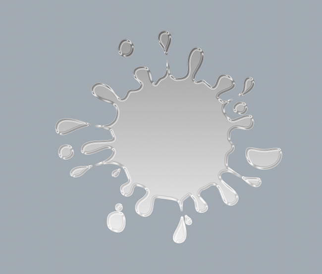

Here's my go at chromifying your splatter -
Looks chromey, even if the light is all weird. I didn't try too hard with it and could have done better with the drop shadow... Oh well! I got that result following three tutorials that all do the same thing.

All are for text, but work for shapes too, as you can see from the one I did. You can skip the steps where they're smoothing the corners of the letters.

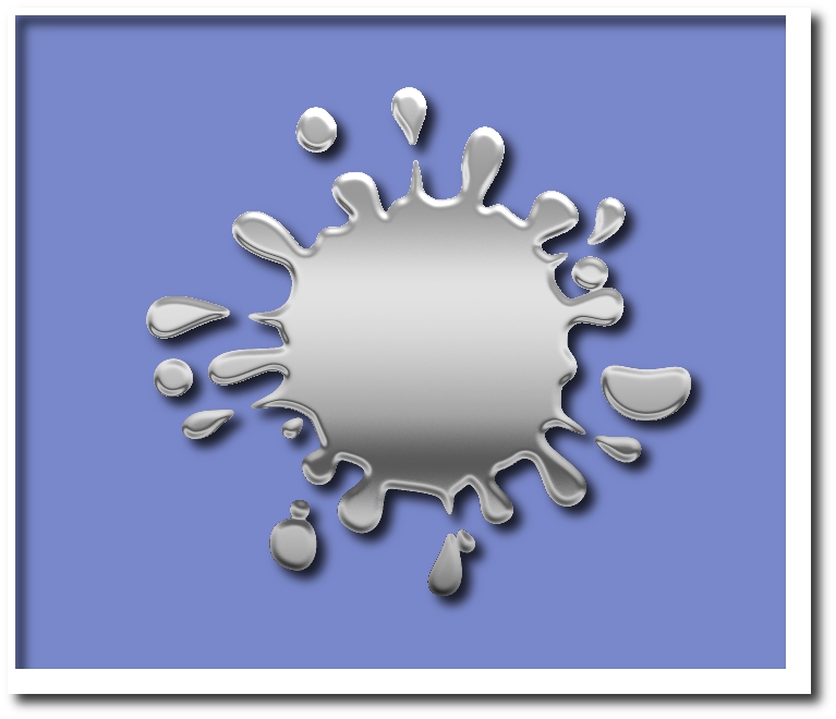

Ok .. and here's what I end up with. I made a boo boo and didn't invert my selection when I was putting a drop shadow and it made it look a bit different.
This is with my mistake of a drop shadow inside the selection
And this one just has the normal drop shadow
I feel like a brain surgeon now! :yes

Wow, I like them both, very good MrBiggz.

Excellent. Yes, you have been through the training and came out well. Love both of them. :gimp

it really does look like liquid chrome, sort of like the evil guy in Terminator!
