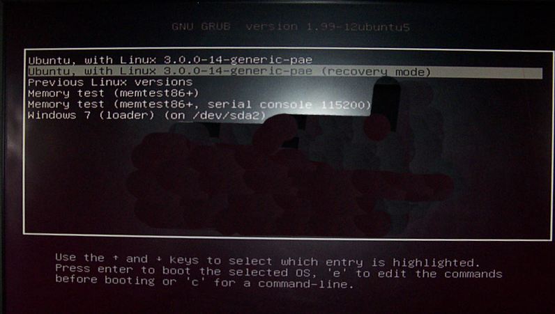

Yes it does Lyle. The top one is ubuntu which opens when I boot up, below that is a test or something ubuntu that I tried and I did the options it had in it and the bottom one is windows. I can't send any screen shots cuz I can't get to anything while that screen is showing.

I may be misconstruing things but based on what is stated in this post, it sounds as though you are choosing the second menu option, "Rescue Mode". If so, don't do this; use the first menu option to boot into Ubuntu.
 Post subject: Re: Can't open Ubuntu
PostPosted: Tue Jan 03, 2012 1:29 pm  (#13)
That is what I have been doing Saul. That is when I get that ICEauthority message. So then I started booting into the second one to see if I could fix it. So far, I can't. I thought when I got to that Dos screen I could type a command in there but then everything I tried didn't work. I need to get to the permissions place but I can't get there.

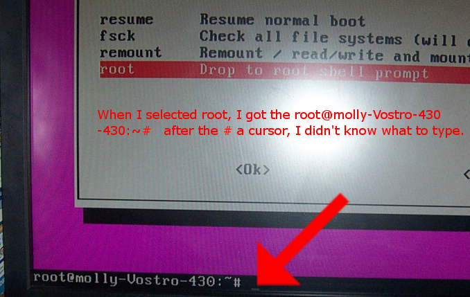

From what i can tell by reading some of the posts from others who have had this problem (never had this problem myself), it seems .ICEauthority is no longer owned by you the user. From the screenshots, it appears your user name is "molly" right?
The chown command changes ownership of a file from one user to another. Issuing the "chown" from terminal using a Live CD will attempt to change ownership of .ICEauthority on the (ramdisk image) of the live CD, not on your hard drive, so don't bother trying that. ;)
Using the last option on your startup screen to get to the root prompt, I would recommend you issue the chrown command from there. Since you are "root" at that point, you don't need the "sudo" (super user do) part of any command you issue from there.
One thing that seems odd is the error message states: /home/test/.ICEauthority. I would think the error message would reference /home/molly/.ICEauthority. In Linux, each user has their own /home/user folder, where user would be the user name. In this case, it's test (and I assume there is a molly as well). Perhaps you installed something that created a "test" user.
Anyway, all of this is just some background info that you might find useful.
Can you drop to the root command prompt (last option on menu) and issue this command exactly as written..
ls -la /home/molly | grep .ICEauthority
Then take a pic or write down the output..
Next issue this command
ls -la /home/test | grep .ICEauthority
This will give us a starting point and tell us whether or not you have both users "test" & "molly".
From there we can go about finding and changing ownership to the correct user.

I have a problem with my keyboard. I don't have that character with the straight line ls -la /home/test | grep .ICEauthority
It is there but it is a separated character and it works in a straight line if I try it in notepad or Gimp. But when I use it in the root command it shows the same as on the keyboard and it comes out as an error when I click enter.
PostPosted: Wed Jan 04, 2012 6:36 pm  (#20)
It's the key just above the enter key. It's shift-\ which produces this | and it does show up as a broken line on the keyboard but it's the right one.
Those are "els" l not "eyes" i so maybe that's the problem.
Try..
ls -la /home/test
ls -la /home/molly
to see if those folders exist. We can change into them and go from there without using the pipe | symbol.
