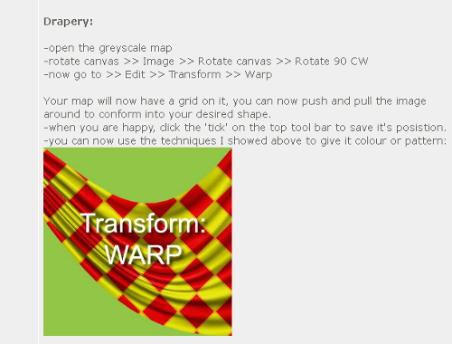

Hi everyone,
I hope 2012 is going great. :)
I have a question. I found a tut on how to drape things like curtains, clothes, etc. I believe they used Photoshop and its transform:warp tool which from what I gather is way different from our iwarp tool. Below I posted the end part of the tut which is the affect I am trying to learn. Any suggestions would be most graciously appreciated on how to achieve this in Gimp?? :)
Liana

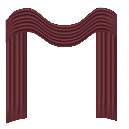

Edit: I did play around some more ( had my thinking cap on) and played with the settings a bit and came up with this. Still not smooth though. :(

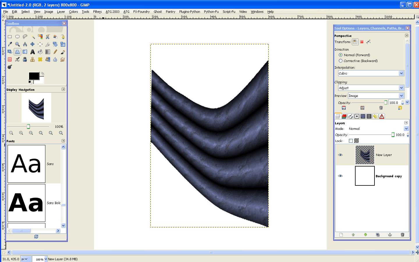

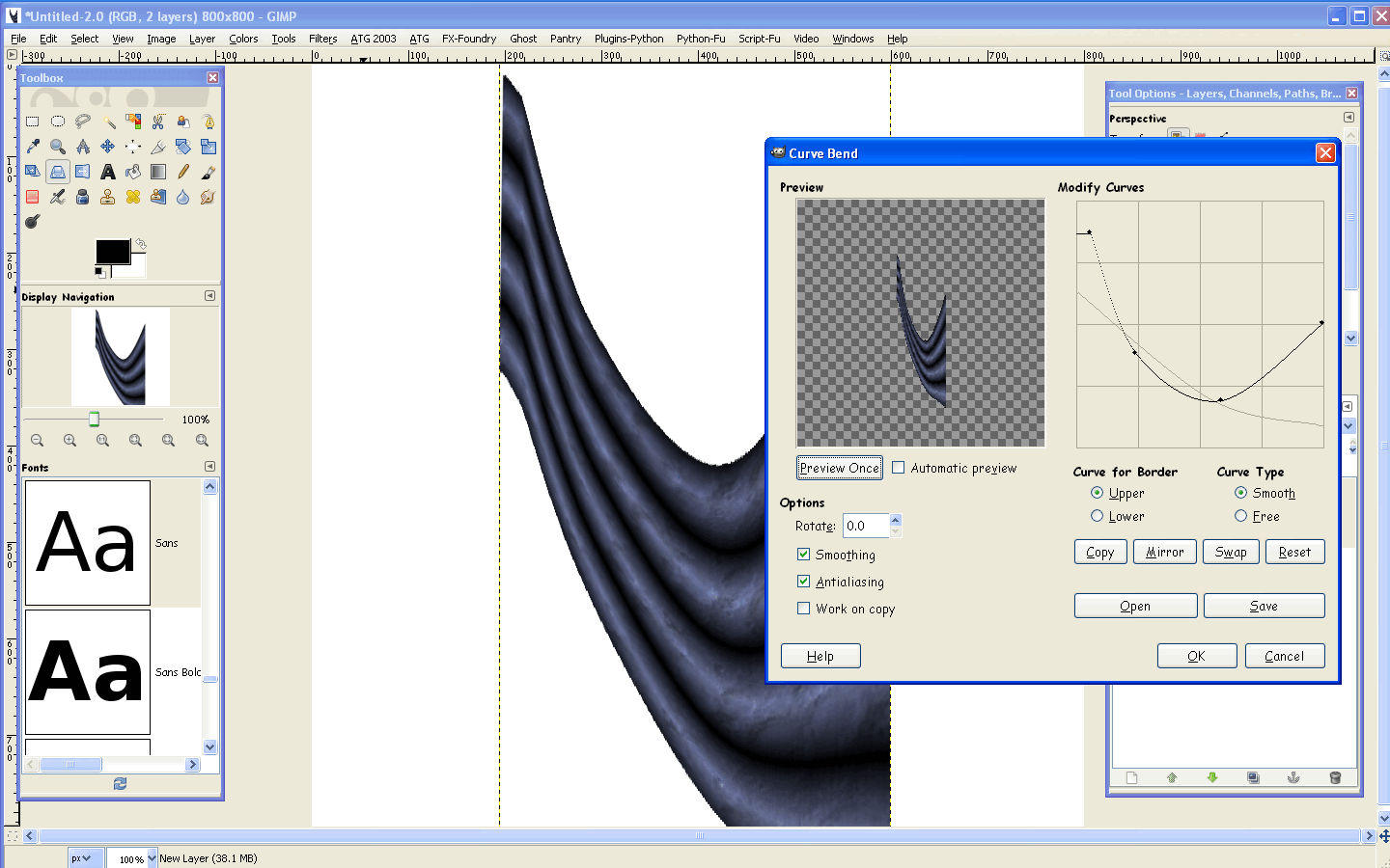

Curve Bend seems to work.
 Post subject: Re: Making an item drape.
PostPosted: Thu Mar 01, 2012 7:18 pm  (#9)
That bends but it doesn't drape. a good iwarp or liquify script will make the gathers as well as the bend.
PostPosted: Thu Mar 01, 2012 7:42 pm  (#10)
Posts: 16306
Yes but if you use Perspective first it looks much better. :)
Bunching could probably take place if you make the gradient folds closer, and play with the lines a bit.

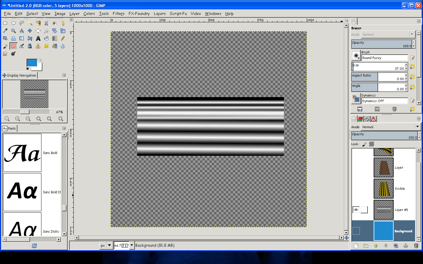

If you use the 4bars gradient and make two layers of it one small bars one large
then set the top layers mode to multiply you get something like this.
Now if you add your pattern, perspective and then curve bend..
Curve bend to path may work even better. :)

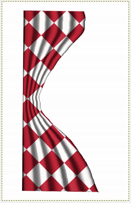

I started with a checkerboard background. Then I used the Selection Blend script fu that was made by RobA. Here is a link to the thread: viewtopic.php?f=9&t=3730
I just made a selection in the shape of a curtain on a new layer. And made a straight Horizontal blend from black to white using the Selection Blend script.
Then I simply used the Free Hand option in the curves dialog box to create a curvy blend.
Then I set the layer Mode to Hard Light and set the opacity down a bit before getting rid of the outside of the checkerboard pattern on the background layer.
Using curves like this is a technique I discovered a while back.
Alan
