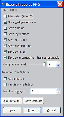

When you save as a PNG, did you also remember to uncheck the "save background color" box?

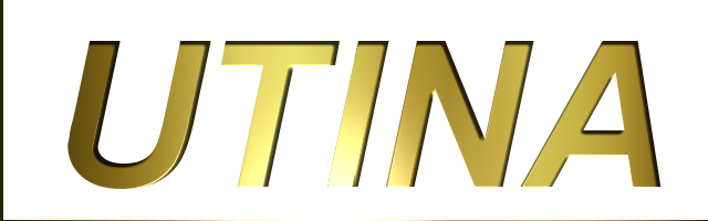

Please help, someone to save the project http://cazadordevarna-kennel.com/UTINA.xcf in .png and sent it to me
deliv.system[at]gmail.com
 Post subject: Re: Loss of transparency when save file
PostPosted: Mon Mar 12, 2012 12:19 pm  (#7)
Got it... you have a floating selection head to the layer mask of the top layer. To save properly, you have to
  1. anchor the floating selection, which puts it on the layer mask
  2. apply the layer mask
At that point you can save with transparency...
