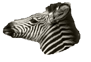

My tres crude attempt, trying to generate a WrapMap using a gradient from Sample-Gradient-along-Path using a "flattened" path (using lasso tool on an out-and-back path). First reaction is "it ain't very saturated: no blacks in it". Second reaction is, it's not fading. :hehe (I ran across a 2D gradient script too, but already suspect it may not take my S-G-a-P gradient as an input argument.)
GraMP

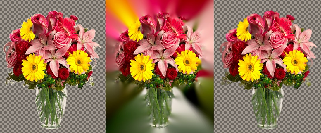

I think i get what you mean.
If you want the colors to create the gradient fill (sun burst effect)
Try Robs version of the Solidify filter by Flaming Pear. :)
It takes an image (with alpha) and creates an outward gradient fill using the colors of the image.
It's purpose is to get rid of halos around the image using the images colors as fill.
It seems this is what you are looking for.
viewtopic.php?f=9&t=3153&hilit=Solidify
Example

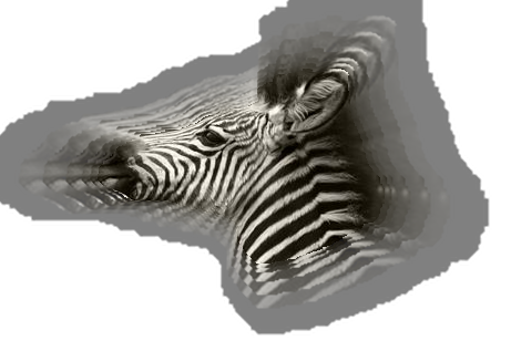

To tie a bow on this, here's my result:
Not really what I expected (I think I expected certain colors to be "more equal" than others; psychochromatically speaking, maybe).
Still perfectly understandable. And I think it will serve my purpose admirable.

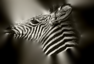

More like this perhaps?

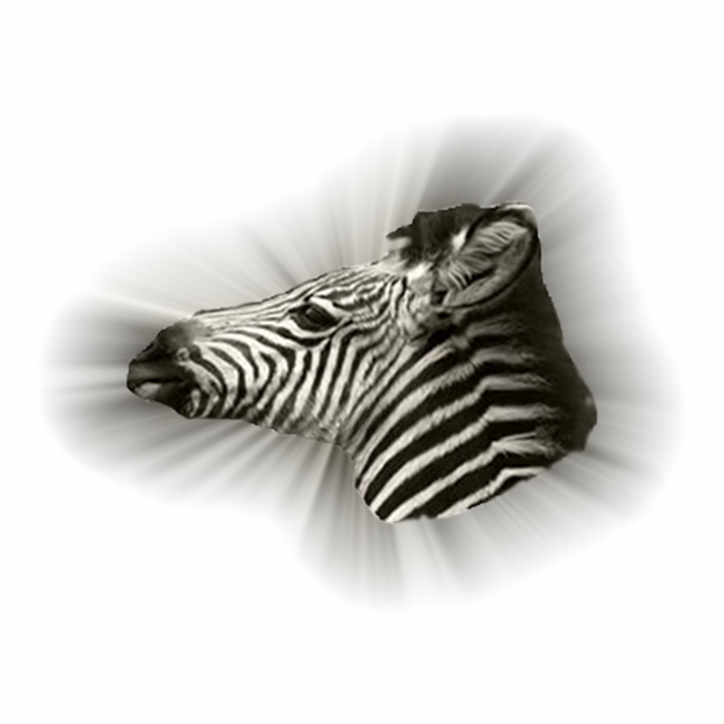

gramp wrote:
"I'll know it if I see it." :mrgreen:

BOING! That fits right in the hole in my vision. Are the rays taking their values from the image itself?

gramp wrote:
@ofnuts
Indeed.
To achieve:
  • duplicate the head layer
  • obtain a 20px border selection around the head:
    • alpha to selection on head
    • Select/shrink 20px
    • Save to channel
    • alpha to selection on head again
    • In channels dialog: right click on saved selection a above and "Subtract from selection"
  • invert selection and [delete] to keep only the rim on the zebra head
  • Select/None
  • Filters/Blur/Move and use Zoom/Outward/ and a length about twice what you want. The result is very faint... but mostly because of very low values in the alpha channel. The rest is playing with the layer mask in two steps:
  • First step to restore opacity to about 100% everywhere (fill with white)
  • Second step to generate the fading effect if needed:
    • Obtain selection on head as above
    • grow to required size for matte cut
    • add layer mask
    • fill selection with "shaped" gradient (black on the outside)
    • adjust fade with the Levels or Curves tool
