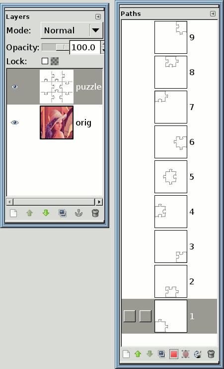

  1. Open your original image
  2. Create a new layer filled with white
  3. "Filters->Render->Pattern->Jigsaw" -- Number of tiles = 3x3
  4. For each of the nine "pieces" of the resulting puzzle, use the Fuzzy Selection Tool :fuzzsel and 1) click on the center of the piece, 2) "Select->Save to Path", and 3) in the Paths Dialog, rename the path to be the "piece number" (1-9). If your Path dialog is not open, open it with "Windows->Dockable Dialogs->Paths".
    Your Layers Dialog and Paths Dialog should now appear like this:

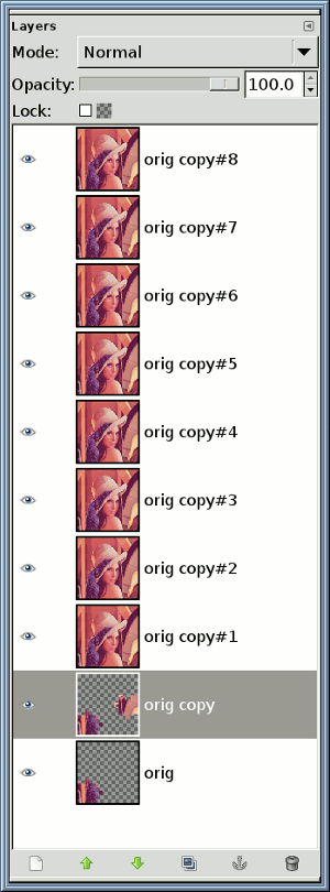

    Here is a screenshot of the Layers Dialog after the first two layers have been processed. Note the checkerboard indicating the transparency around the puzzle pieces.
  16. Repeat steps 12 through 15 seven times until you reach the layer that is just below the topmost layer in the layerstack.
  17. Add a new layer and fill it with the background pattern of your choice.
  18. Move the new layer to the bottom of the layerstack.
You now have all of the layers of your animation, you can optimize the file ("Filters->Animation->Optimize") and save it with the .gif extension (specify a delay of 1000ms).
