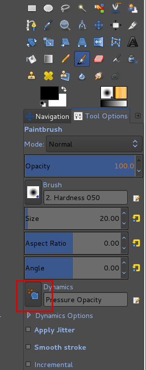

sorry to seem like a complete nincompoop but do you think I an find Random Colors...sure I have seen it somewhere but I must be drunk or something bc I cant find it now
 Post subject: Re: Is there a way to have gradients work with pen tool??
PostPosted: Fri Aug 31, 2012 6:47 am  (#12)
Akky, under dynamics, random colors is in the drop down menu, just click the button hi-lited in red

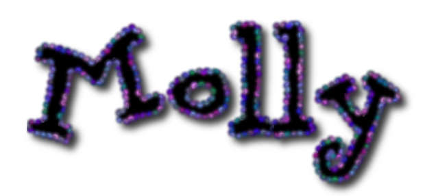

Stroked with gradient
