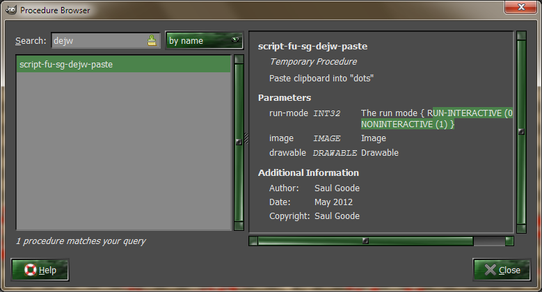

It doesn't show up in GIMP 2.8 Saul; tried re-opening GIMP after refresh failed but to no avail. Not sure why. Would be a cool way to use stipple output for this one too. Anyway, programmer I'm not so maybe someone else can verify this and see if it's just 2.8, 64-bit GIMP or some variation as to why it doesn't show up in misc. :)
edit:
It does show up in procedure list though. Weird. :)
edit:
My mistake (nothing to do with GIMP versions). I renamed the script and missed one of the places where it needed changing. Thanks for the report.
I have updated the download link in my previous post, or you can just change the line at the end to:
(script-fu-menu-register "script-fu-sg-dejw-paste"
