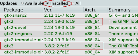

I have both GTK2 and GTK3 installed on my system.
I suspect the problem is an app needs to use one or the other and you'll get that error if the package is compiled against a mix of gtk2 & gtk3 libs.
