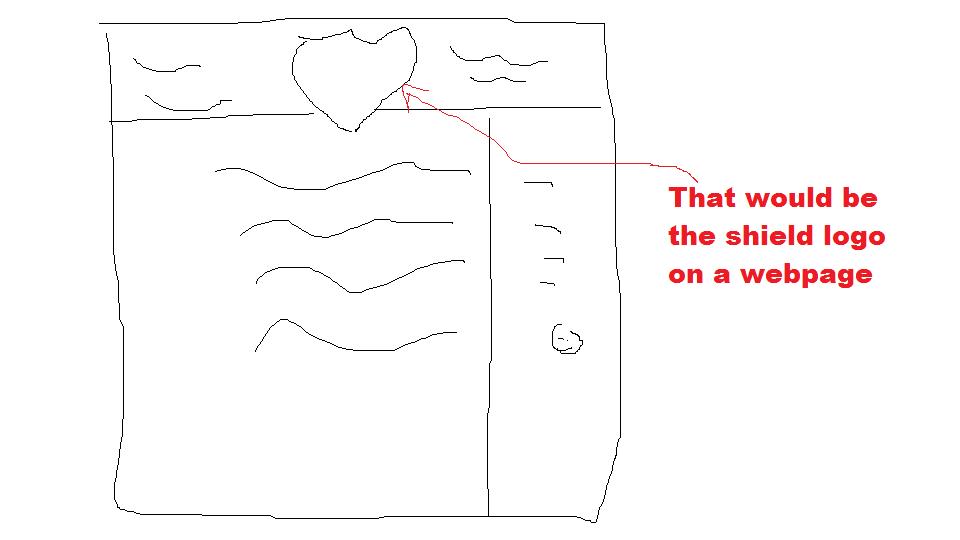

Is there anything I can do to give this some depth make it look more badge like? This is rather a really crude drawing of what I'm hoping to do. It's in my head right now ( <- scary thought) The idea ->
