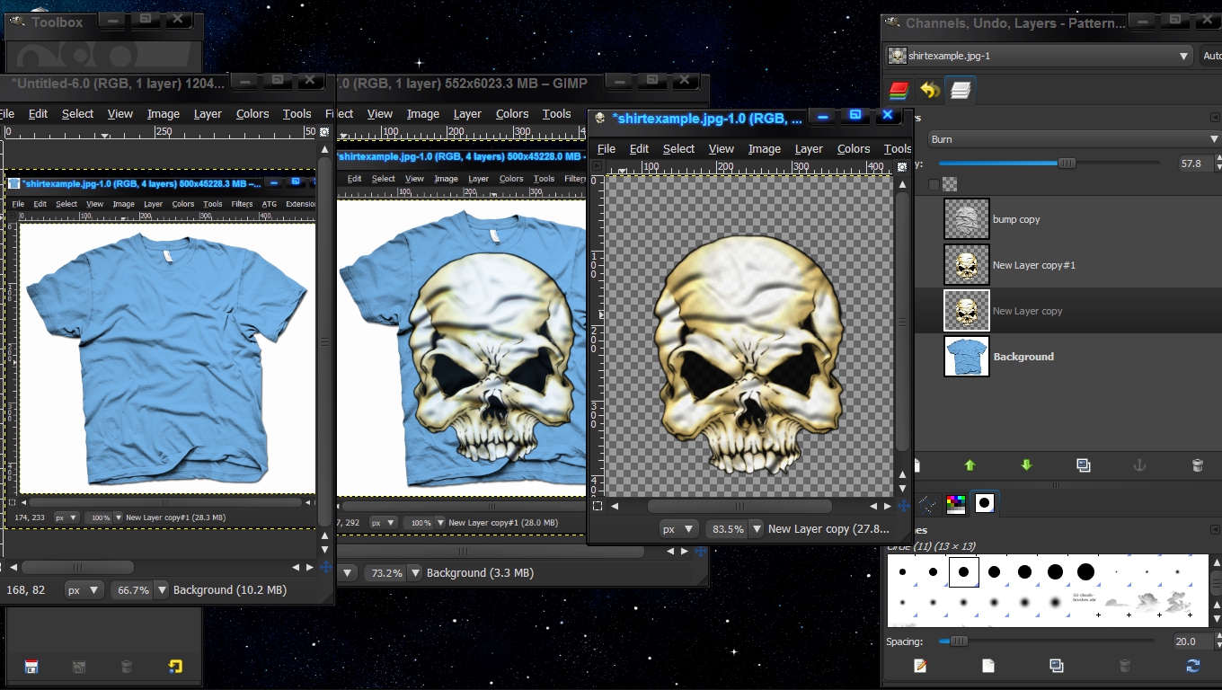

I followed the same tutorial and this is what I came up with using "bump-mapping" and and overlay of the desaturated bump copy. I also used the bump copy for the displacement map.
The original skull layer mode was set to burn, and a copy of that layer with the mode set to normal, lowering the opacity a little.
The bump/displacement copy was put on top and set to overlay mode and also lowering its opacity some.

PostPosted: Mon Dec 30, 2013 6:37 am  (#13)
Very cool Wallace, nice job, so you didn't use displacement?
 Post subject: Re: 'Underlying layers'
PostPosted: Mon Dec 30, 2013 6:47 am  (#14)
Posts: 14283
Yes I use displacement, just forgot to mention that. I did edit my post adding displacement. Sorry...
