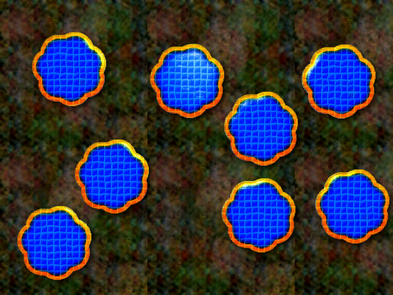

Try it on shapes.

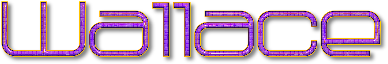

Some for the holiday.

Also, test on shapes. Nice look, too. :)

I need to work on the small letters a bit. Nice script, Rod! :yes
One wee problem: When I choose hexagons in the script menu I get squares; get hexagons for squares.

I used Octagons & Squares option.

PostPosted: Sat Dec 05, 2015 9:53 am  (#13)
Posts: 16302
Not sure what the problem is there O i will look into it. Possibly the settings for shape size.
Here is another effect from spacing the letters before running the filter. :)

 Post subject: Re: Finished the Reptile Effect Filter
PostPosted: Sat Dec 05, 2015 4:48 pm  (#15)
Posts: 14281
Check it out...Image
PostPosted: Sun Dec 06, 2015 5:29 am  (#16)
Posts: 16302
Wallace wrote:
Check it out...[ Image ]
Nice Wallace! :bigthup
